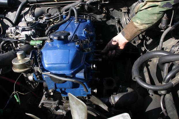

pics
engine in truck
and repair manule he tossed in for $5.00
look donor engine $100 gota love craigslist
happy yotaing
Ken

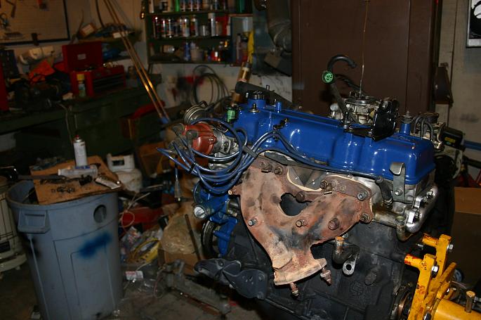

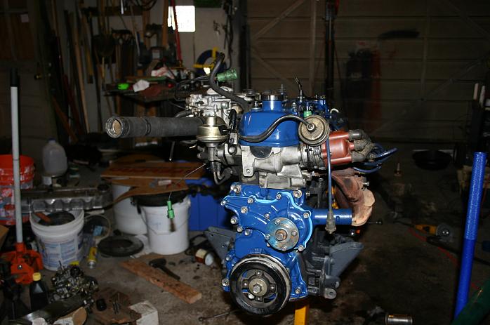

more pics from todays work
I got the engine redy to pull
and looked over the new one I dont think it will be a problem at all
pic 1
taking the distbueter out
pic 2
nice paint
pic 3
dont forget to put your bolts and nuts back whenever you can
Ken

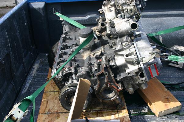

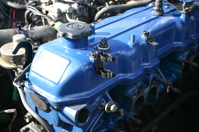

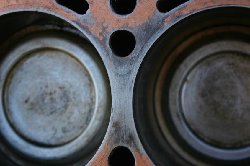

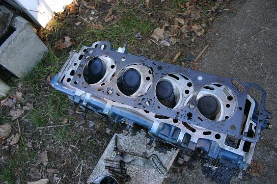

well.... here is some pics
the gasket was messed up
the block & head showed signs of leaking between 1 & 2
block seems fine head 2 warped
I just put this in and fired it up and it blew the gasket
Oh well differant motor goes in next
I am going to gasket kit it tomrow
Attached Thumbnails Coolant squirting out the radiator on start up-img_6838.jpg   Coolant squirting out the radiator on start up-img_6839.jpg

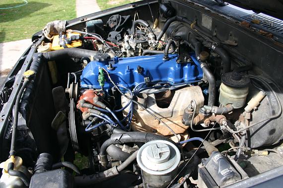

its all together
had some minor problems
like #1 piston was lose in the wrist pin so #1 out of the old engine in to the new
but other than that it went like butter
if any body knows how that gasket could blown after only running for a few minuets
let me know
but new engine goes in tomrow
Ken
Attached Thumbnails Coolant squirting out the radiator on start up-img_6842.jpg   Coolant squirting out the radiator on start up-img_6844.jpg
