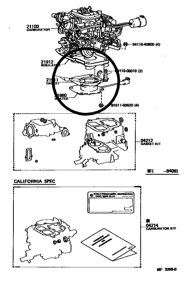

On my old '87 with carburetor, there is a plate on the bottom of the intake manifold (with gasket) that housed the electric carburetor heater.
The purpose of the heater is to atomized the fuel until the engine warmed up. And, but I'm not positive, it also warms up the coolant in the passages in the manifold. Coolant does flows through the intake manifold. There is a return hose and port towards the back (firewall) of the manifold.
You may have an issue with the hose, than a gasket.
