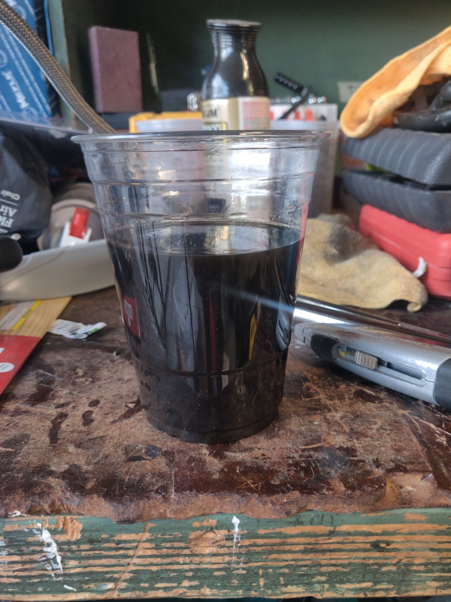

I'll work on getting pics. Oil is showing no milky color from dipstick. Will drain some oil from the pan to a glass and see if Its milky--maybe theyre mixing outside?

Took an oil sample from the oil pan. The oil looks dark and dirty but not creamy. I checked the dip stick but the oil is looks clear (in-fact, it looks clean). I went ahead and did a compression test and got the following results: 158, 152, 165, 155.
Next step is to do a radiator/coolant pressure test to see if I can spot the bigger leaks but Im open to any other suggestions. I'm starting to think the oil/coolant leak is happening outside since there are multiple coolant leaks. I also dont know but maybe someone added UV to the Oil at some point?
