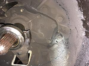

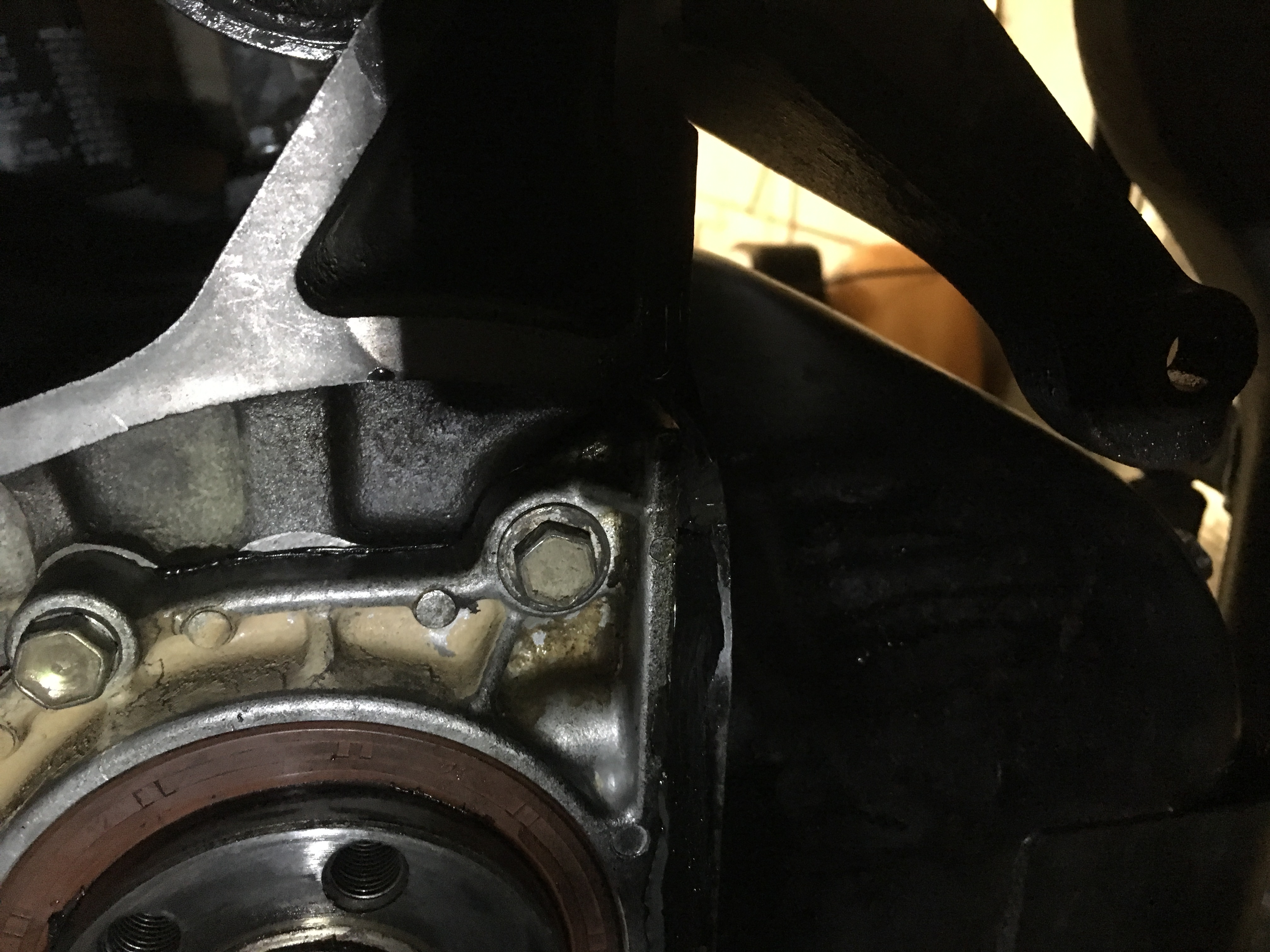

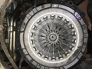

Well I had a friend help me drop the tranny quicker than expected. What was the culprit???
Issues found so far
1. One of the two clips holding the fork was missing. Can't find it. Ground to pieces? Lost during rebuild?
2. Five of the six bolts on the flywheel were backed out and one was just tight enough to prevent my fingers from breaking it loose.
3. One of the five bolts on the rear main was backed out.
The good.
new parts were actually used so I didn't get all the way taken, just most of the way.
if you notice anything else obvious don't be afraid to let me know, I'm not the most mechanically inclined (that's why I paid to have it done).
