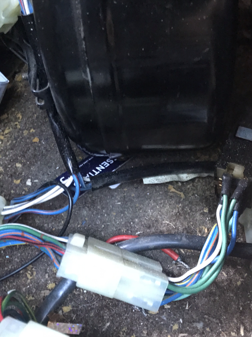

Okay, so I found a center console (rear heater) in a junkyard truck.... I have as pictured the heater some the wiring harness (ish) and I took all the lines underneath including the heater valve with the T.
so wiring seems simple enough... get power to the fan that blowes.... I'd really like a wiring diagram of this or what kinda relay/fuses if someone knows.

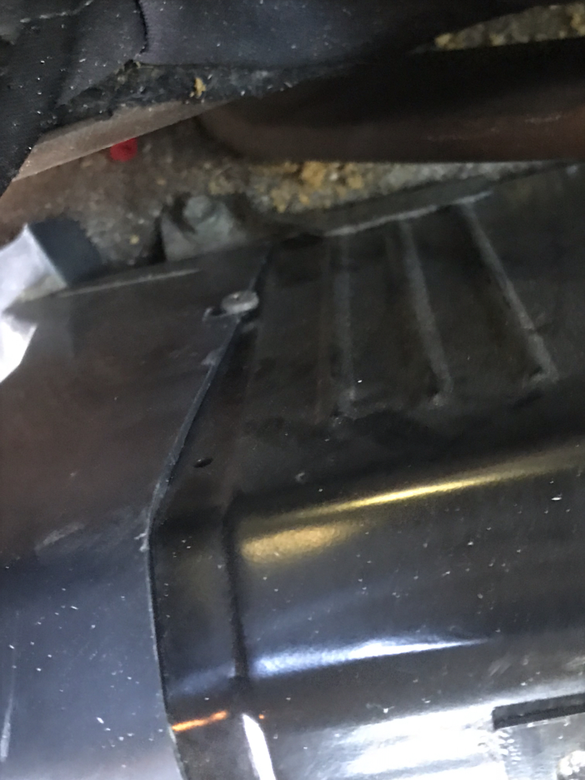

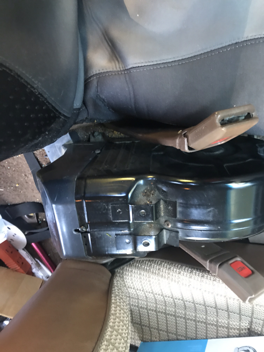

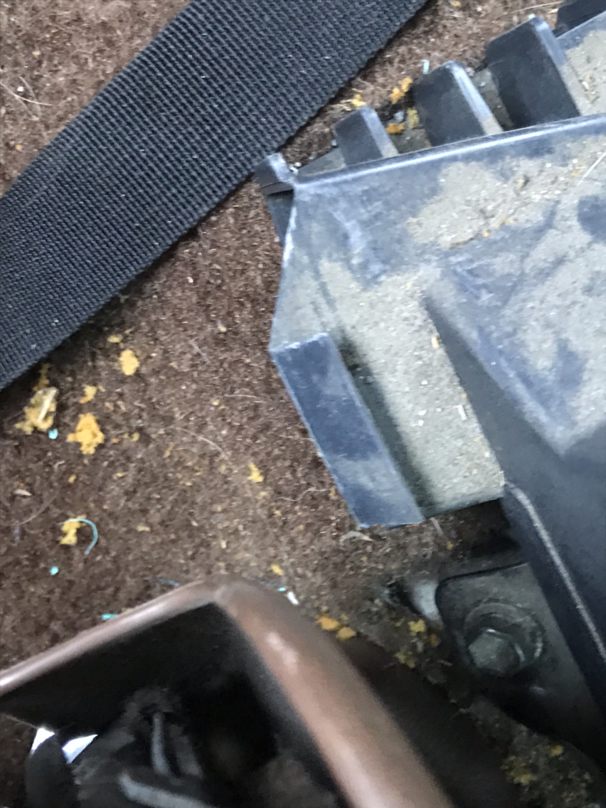

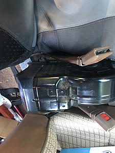

Some pictures. Let me know if you need more and what specifically you need. The holes on top of the heater on the 2 metal brackets are mounting holes for the center council
This is from an 85 SR5 4Runner 5 speed 22re 4wd

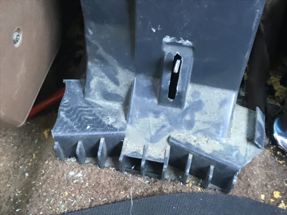

I guess it's this piece. I was gonna put my switch up front

If i jump this with the previous picture showing how i wired the replay it will click... but no fan..

You have two three position plugs, H3 and D (not pictured in the screenshot).
H3 pin 1 is ground, H3 pin 2 connects to IGN, H3 pin 3 connects to rb2's 80 amp FL..
D-1 is ground, D-3 is the relay control, D-2 is the switched power.

Oh ya that's awesome. I looked all over for that diagram... so black yellow can go to the fuse box white can go directly to the battery and black white is ground..... then I just need a 3 phase switch that hooks up to that plug so off low and high.
