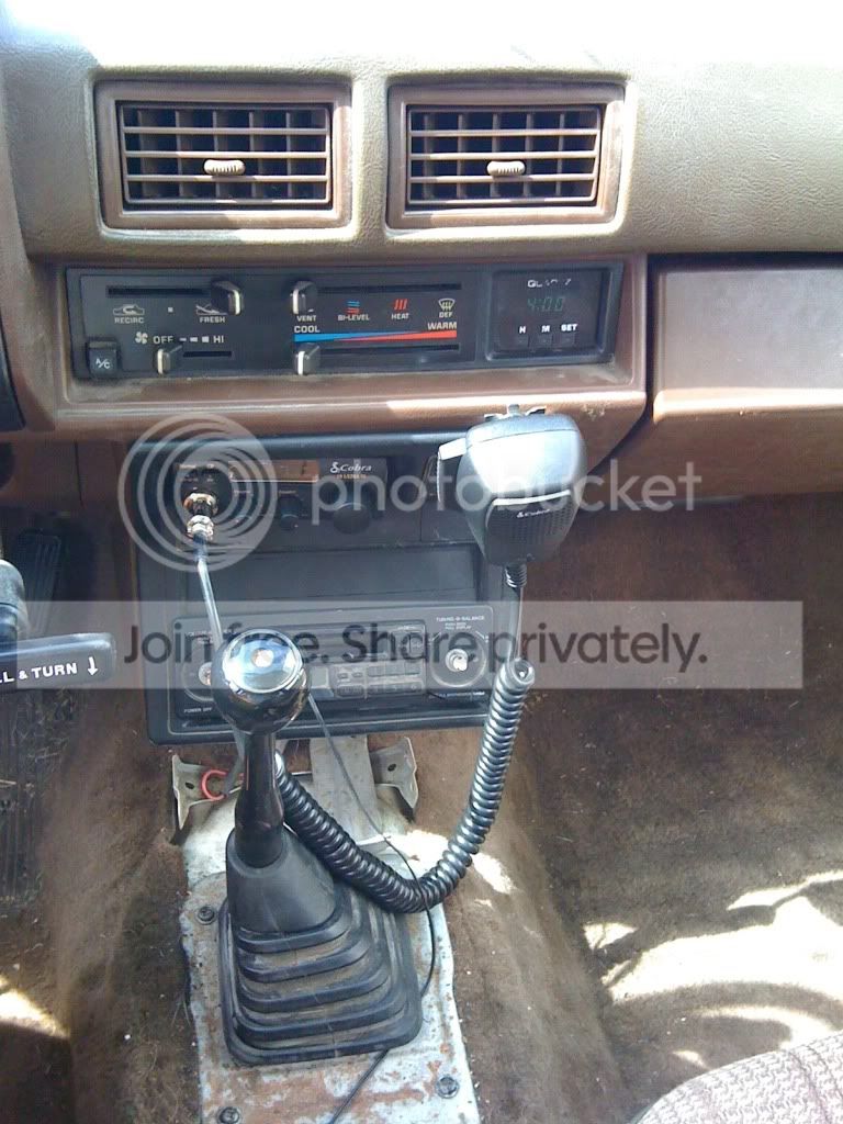

ok here is how i installed my radioshack trc 503 ( not the best radio, but it was the only one small enough to fit). my antennas are in the mail now and i will update when i get them installed.
the first picutre is what the dash looked like before i got my cb in and before i got my stereo installed.

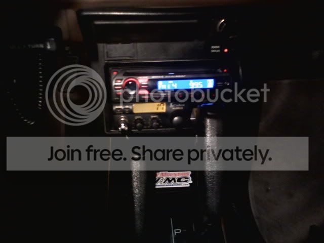

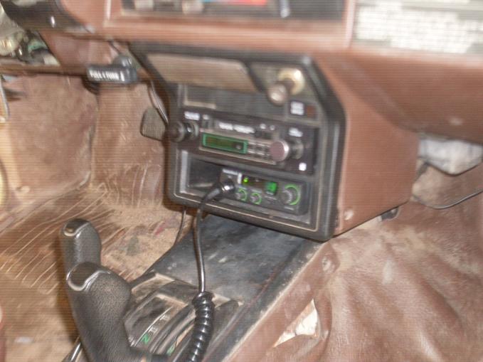

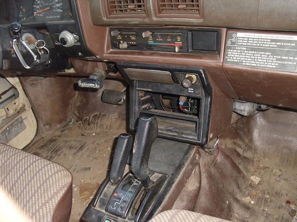

the second picture is the trc 503, its alot lot smaller in person, and in the third pictuture show the tray underneath the radio where i wanted to put the cb. i had to do some cutting to get it to fit

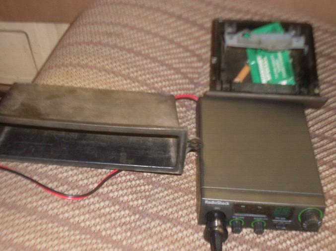

i cut the tray out with an air grinder so it was almost hollow that way i could slide the cb in and acces the the male plug for the co-axial cable and run my wire to the fuse box.

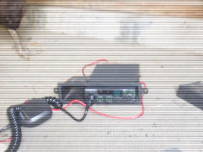

here is some more pictures of the way the cb fits in the tray while it is notched out.

forgot to show a pic, but i mounted my mic bracket kinda behind the steering wheel, there was a "blank panel" there with an unhooked push starter, so i just unscrewed one of the screws and then screwed in my mic hanger
if you look at the first pic, youll see the pushbutton im talkin 'bout. that was a pic from when i first got my truck so thats why its all dirty lol
