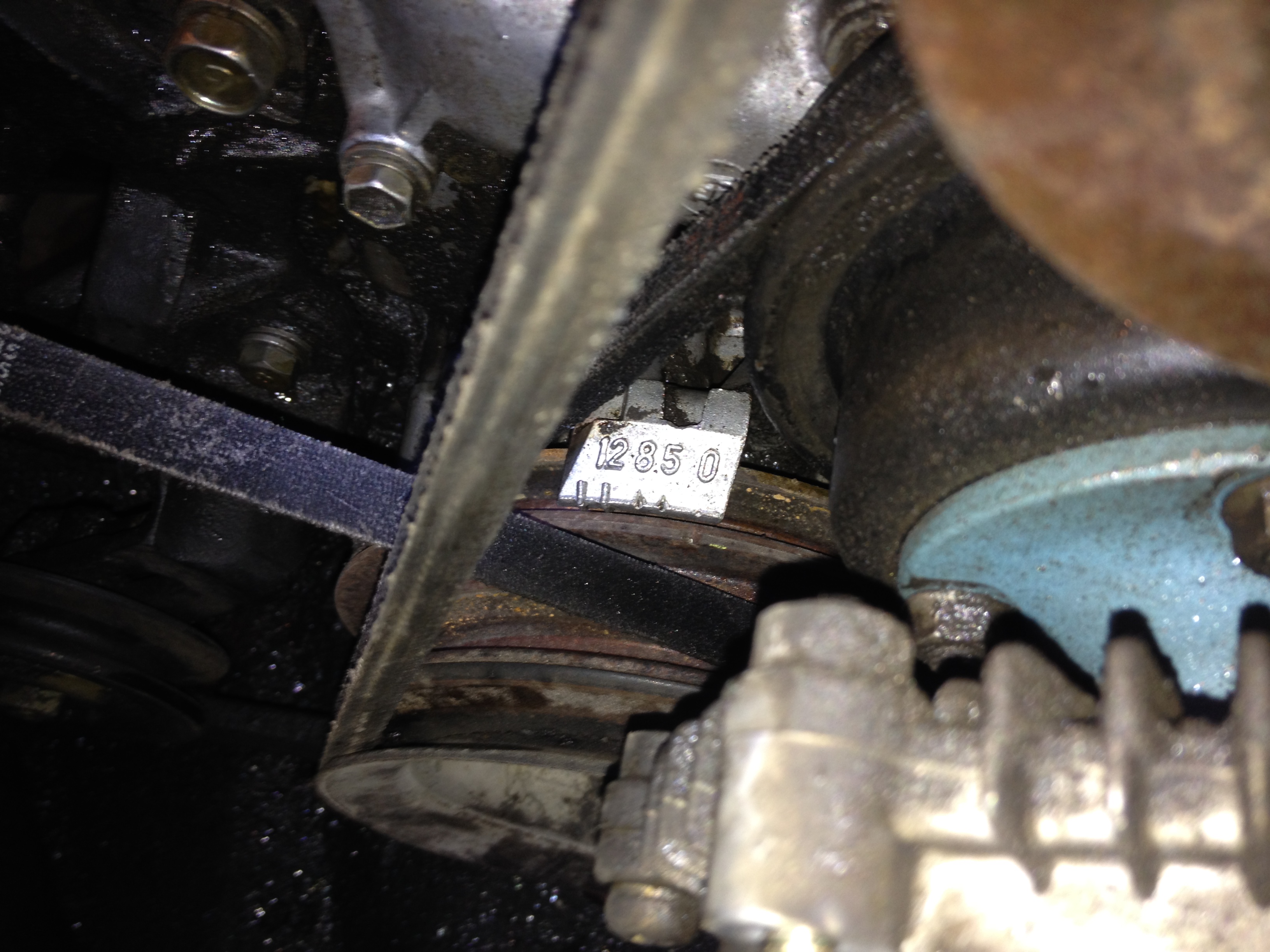

Carb or timing
OK all. Finally getting time to look at this thing. Have photos if you need also.
Still backfiring on acceleration. barely idling. So I pulled the plugs and set timing at TDC. pulled dist cap and rotor is pointing to #1 plug. Pulled valve cover and timing mark is at the top of sprocket. Pulled balancer bolt and the keyway is inline with the timing mark at the top of the pulley. Checked clearance on valves. Going to check compression.
on the new carb. the site glass is over 1/2 way in the glass its about 1/8 of an inch higher. Carb company said this is because it's idling?! Told me to unhook the three top vacuum lines. Having trouble uploading any photos or movies so you can see the marks and hear the engine run.
