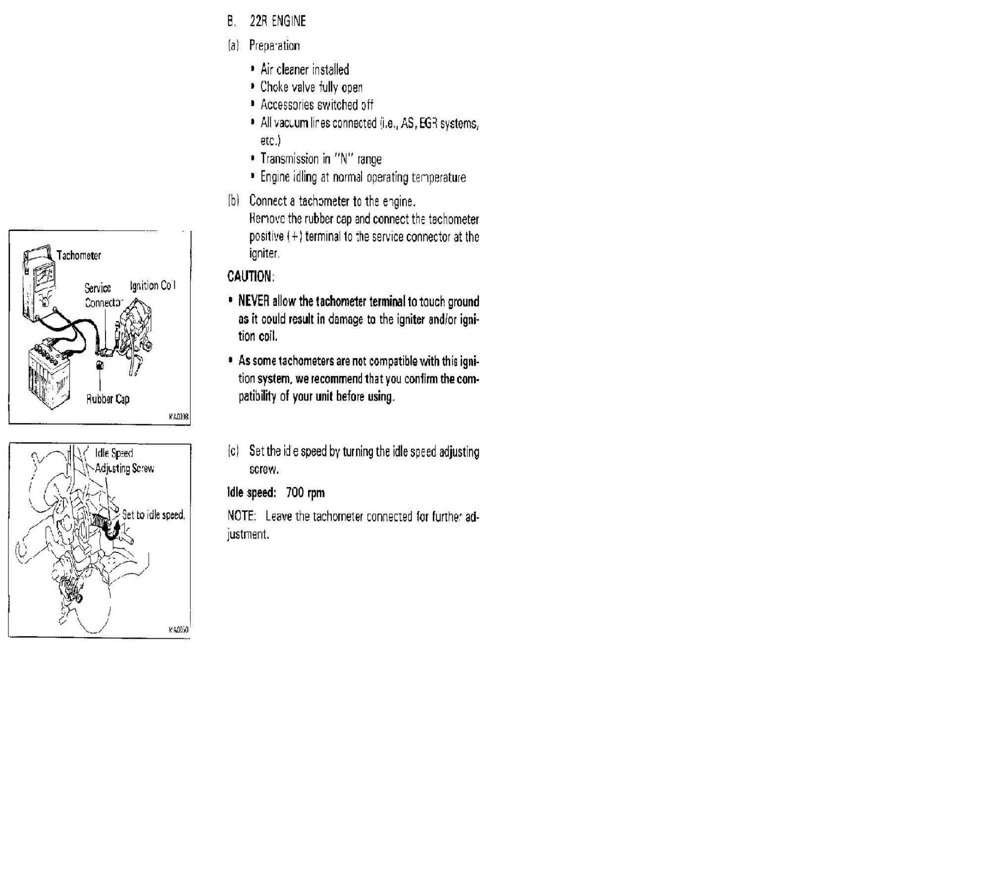

Do you have initial timing set properly? Are you adjusting the right screw for idle speed? Don't be offended. Link below to download FSM if you need it.

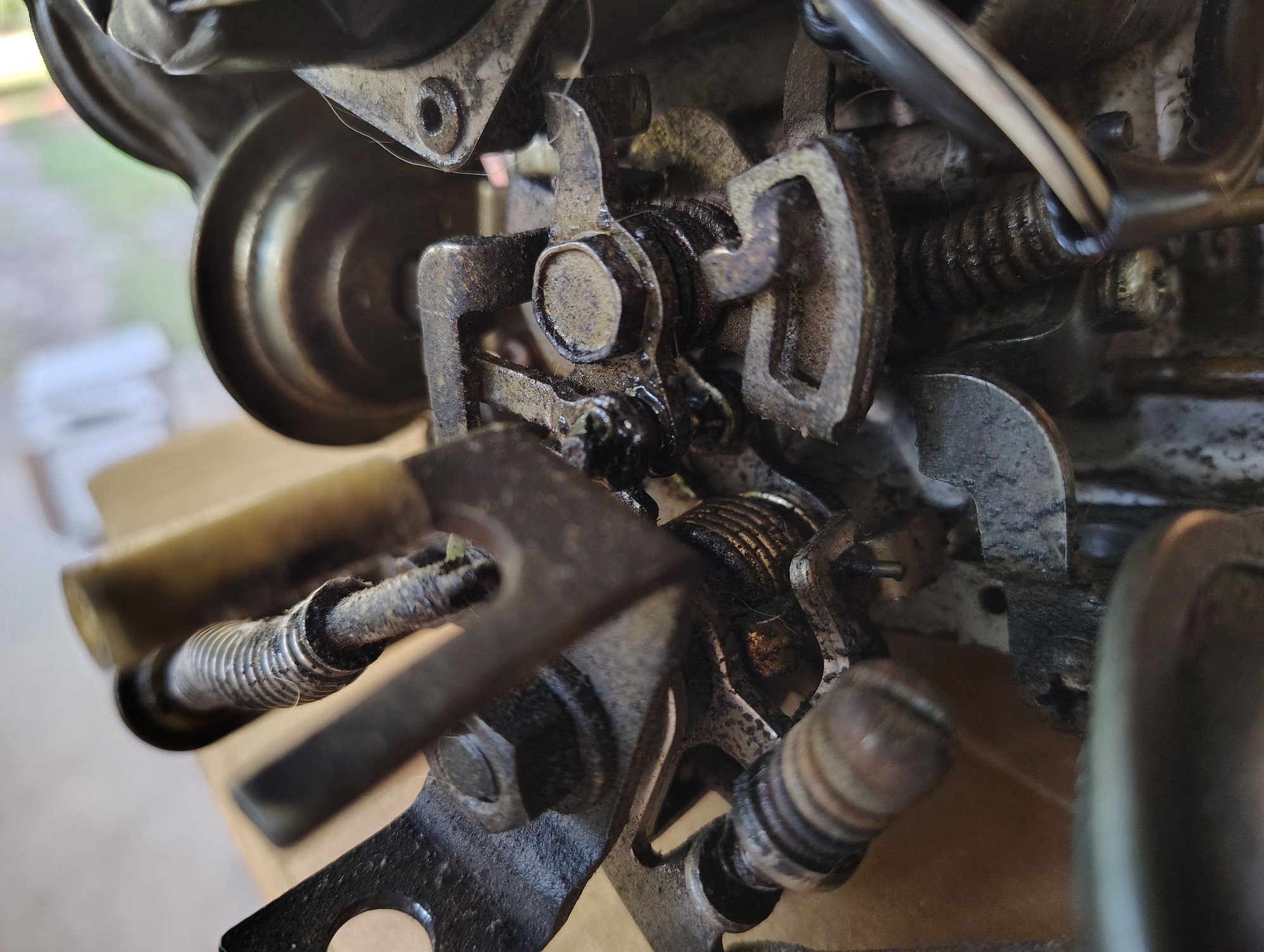

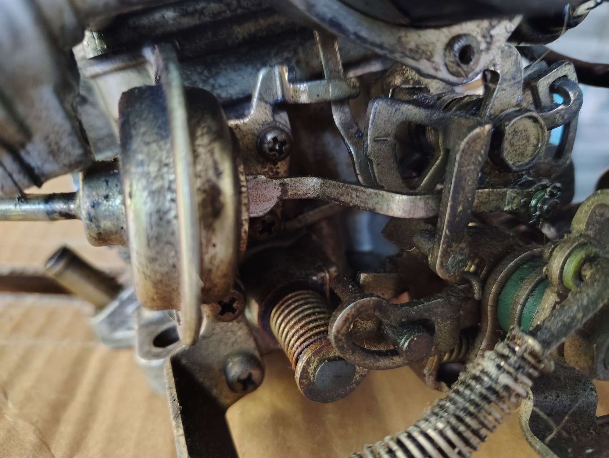

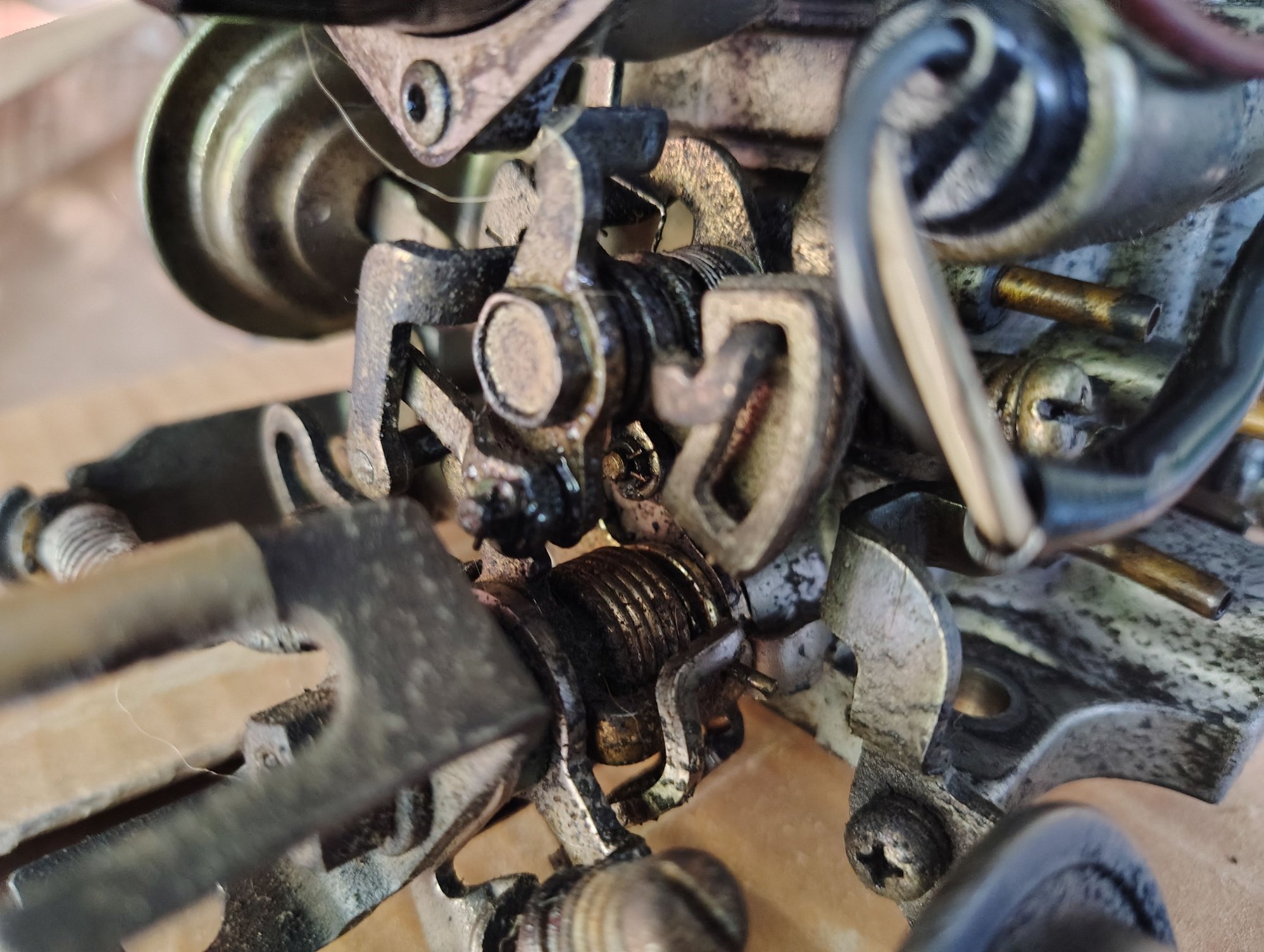

Double check the linkage. When I rebuilt my carb I had to dismantle the linkage. Pics from a spare carb I have on hand.

Thanks for the pictures. Everything looks right where it should be. Going to make sure all hoses are going where they’re supposed to next
