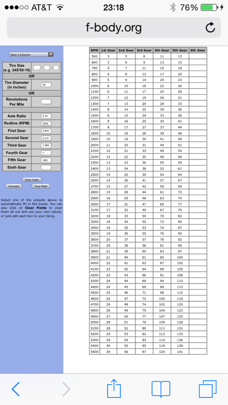

This should help:

Ooh, that's pretty cool, thanks CamTom.
So then, about 40 mph in 2nd and about 60 mph in 3rd are 4000 rpm. Good to know.
I agree that there's not much power higher than that but on a lot of hills around here, it won't pull in 3rd but it will in 2nd, so it can help reduce the rage of those behind me by spinning a little faster and getting the speed a little higher.
