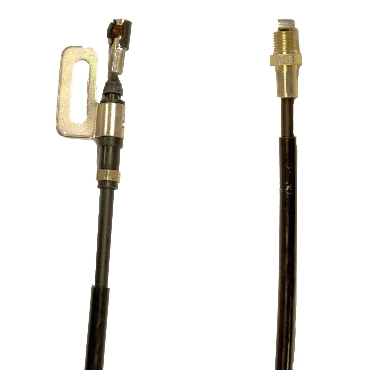

To put a wrap on this subject . . .
The throttle cable measurement for a carb'd pickup 84 - 88 is 24 - 25 inches as pictured below. An 83 or earlier does not interchange as mentioned earlier.
I lined this one (from an 87) up with the one on my 84 and it is right on.
From my research the correct length is not available new. Probably because of the age and somewhat limited year and application range.
What is available, and what is semi-erroneously listed for these years, is too long at 38.5".
I would imagine some of the difference is in the open length of cable, which would be a problem.

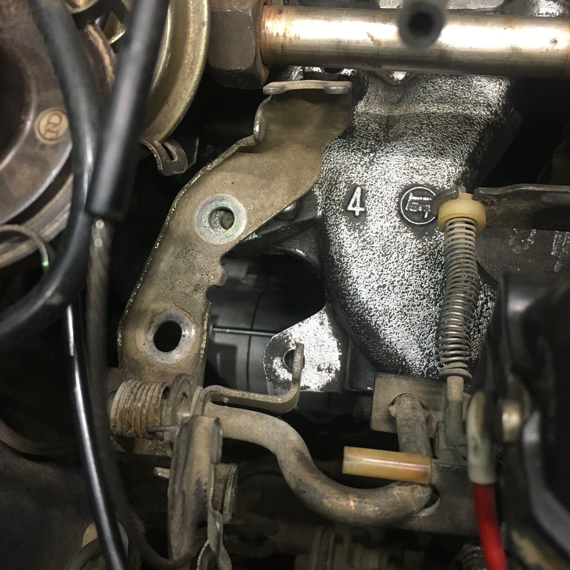

Can’t figure out how to remount it
The bump on the manifold under the linkage is in the way.
hey I’ve searched around a bit and can’t find a picture that helps me make sense of this. I took it apart months ago and don’t think I am missing anything, but I can’t figure out how to remount the throttle cable linkage. I’m sure it’s skmething simple but yeah. I posted some pictures.
I cant get the bolt holes to line up straight and flat to the manifold when the lever is attached to the carb.
Also when I turn the linkage on the carb, I am only getting one of the flaps to open. Shouldn’t they both open at full throttle?

Nevermind about the linkage. I just found the bracket. Still having the potential problem with the butterflies in the carb.
