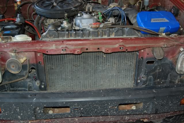

Some Progress
Well, I was able to get a few things done on the AC this evening between the phone ringing and having to go find a new bolt.
I started by removing the grill, hood latch and front support bar for the latch and ended up with this...

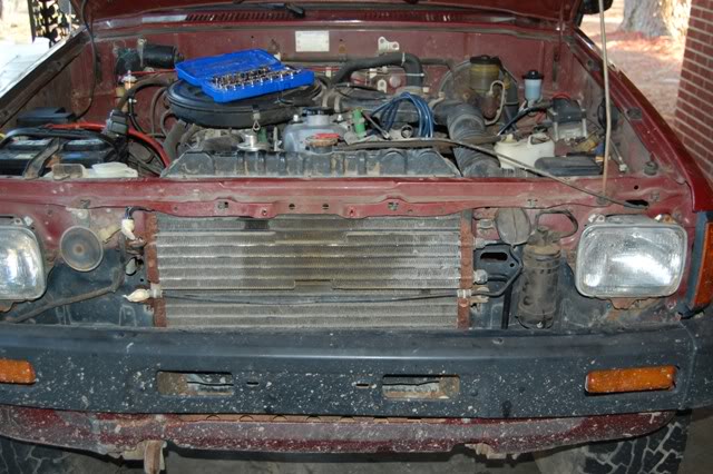

I went ahead and installed the condenser and old receiver and hard line back to the firewall. I'll swap out the receiver tomorrow morning. This pic doesn't show the hard line connected, but I will try to remember to snap one in the morning.

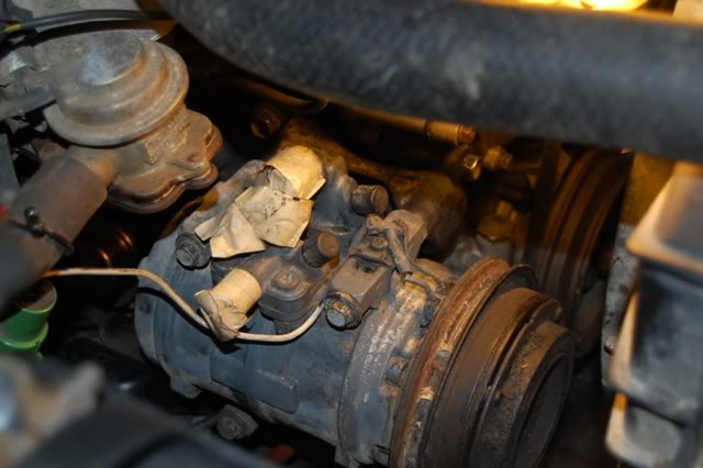

I went ahead and started with the compressor install next. I removed the 4 needed bolts from the timing cover and the water pump. Then I installed the bracket using the longer bolts I pulled from the donor truck earlier today. I also had three bolts to go in the side of the bracket against the block. There were several different size bolts that were used here, so I can definitely understand now why there were no takers earlier in trying to help identify the bolt sizes for the install. I went ahead and installed the compressor next by using the four long bolts from the donor truck at the junk yard.
