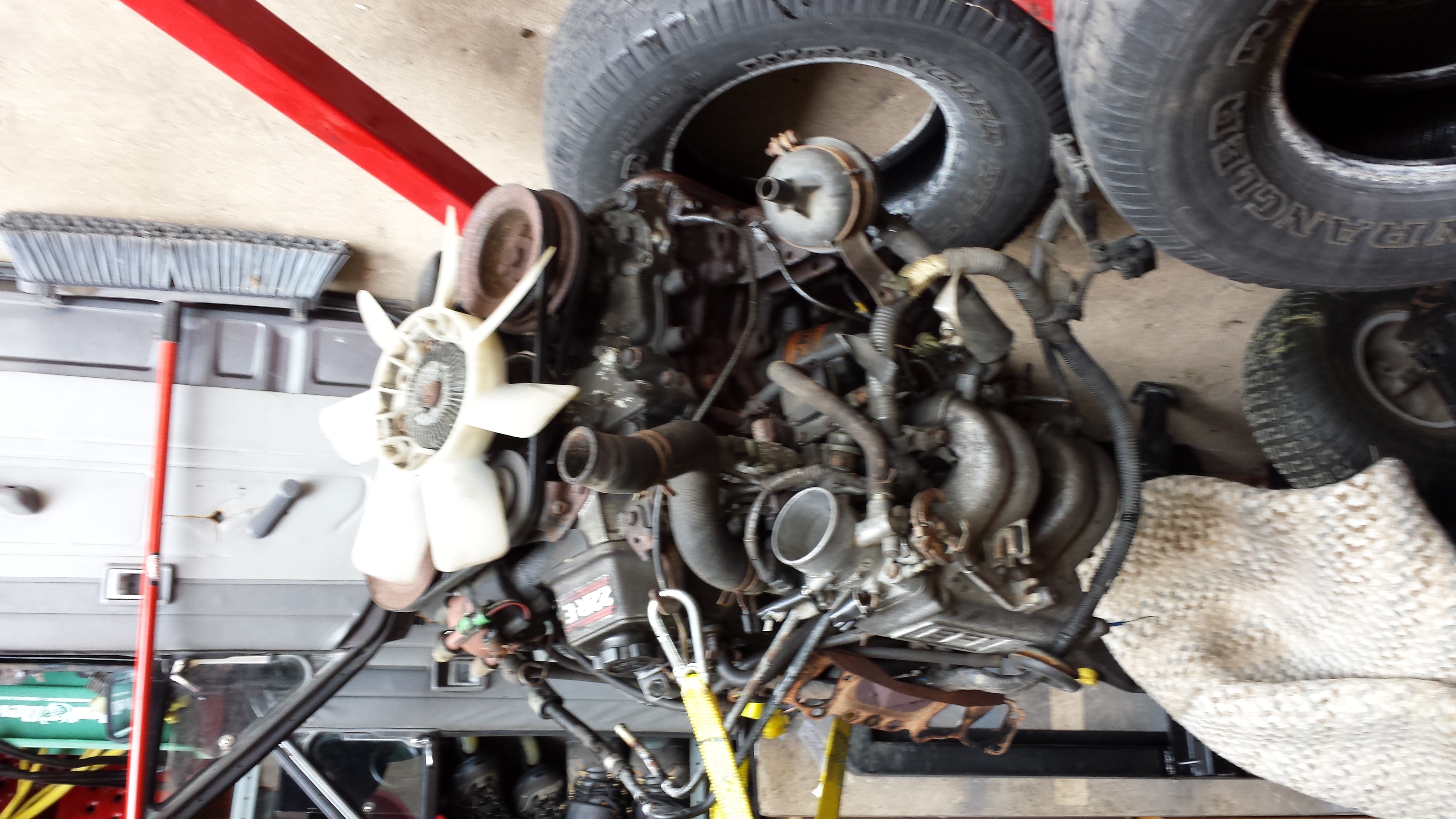

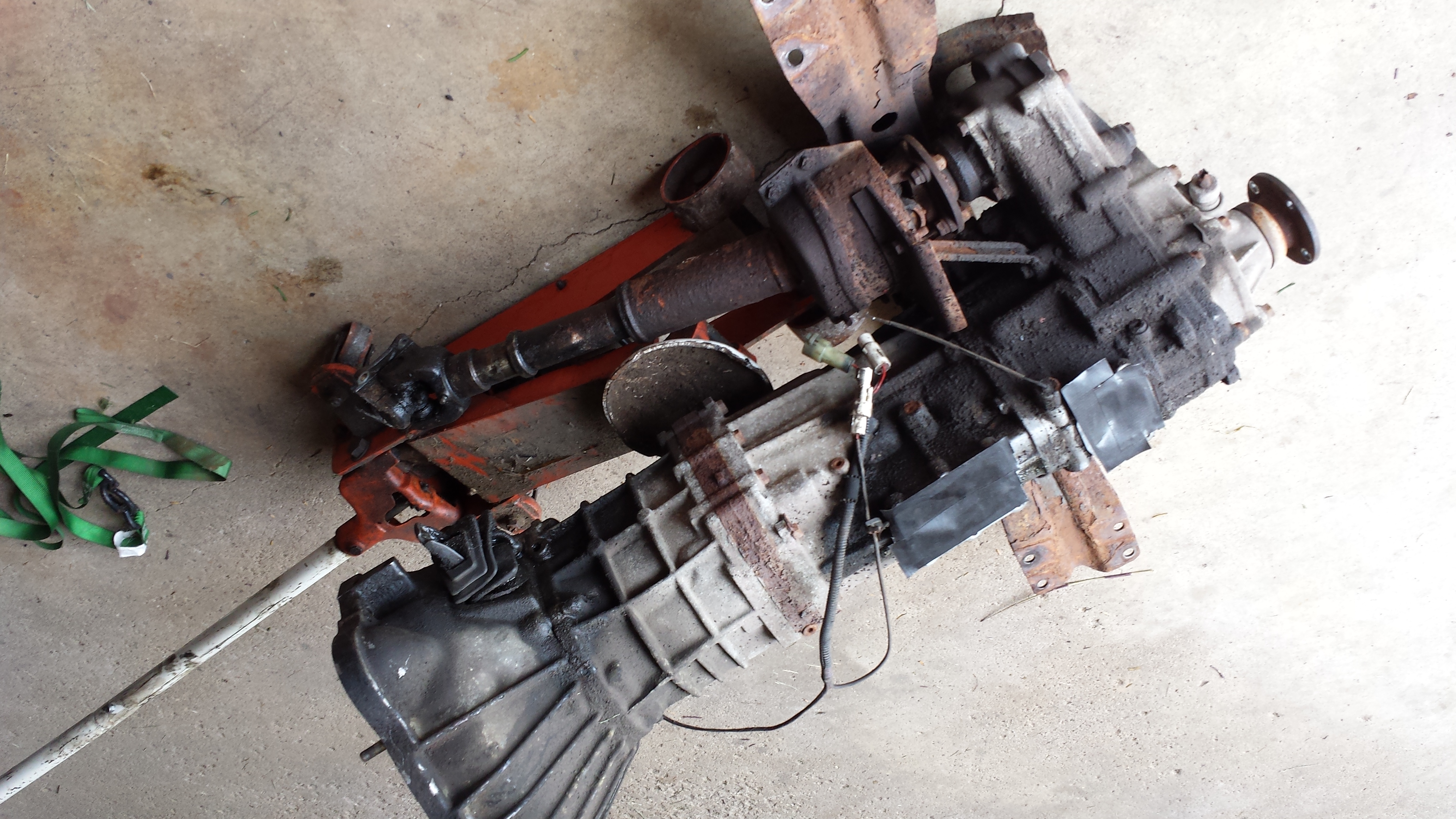

Old Jul 2, 2016 | 04:57 PM
speedy gonzales's Avatar
Joined: Nov 2015
Posts: 18
87 is all out..
I'll work on the 85 Tuesday
Fun stuff when you do it by yourself.

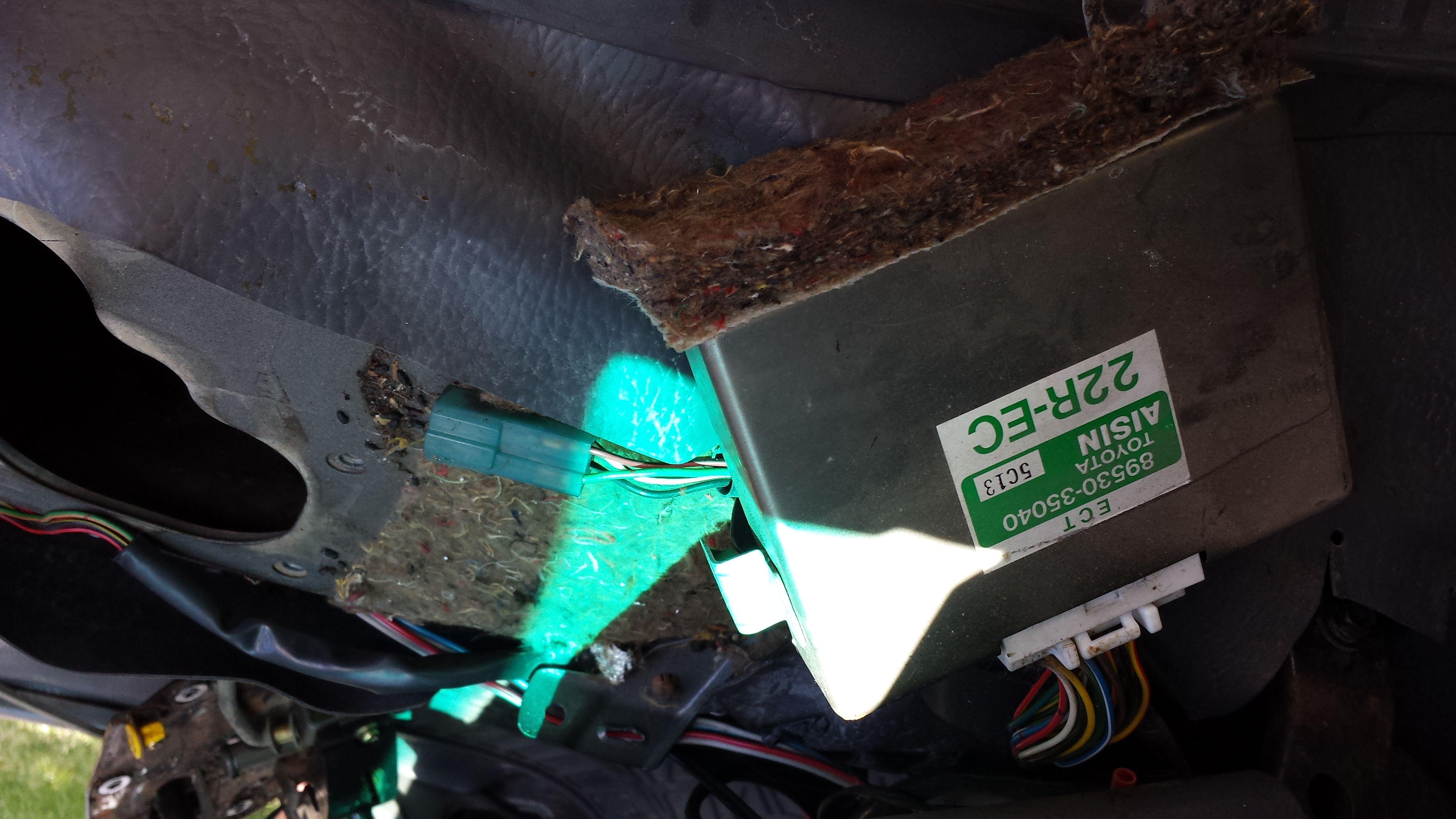

Old Jul 5, 2016 | 11:42 AM
Joined: Nov 2015
Posts: 18
So this is under the center console.
Transmission control unit?
Unplug it and forget about it?
