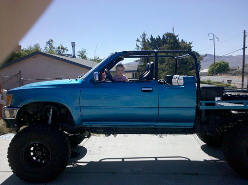

and the superwinch hubs are blue

cool rig. Hard to tell but i bet you can mod a set of stock hubs to get them to match and have a stronger, tougher set than the super winch hubs. Just my 2 cents.

x2 on painting the stock hubs. Its not really difficult.
Nice lookin truck.
