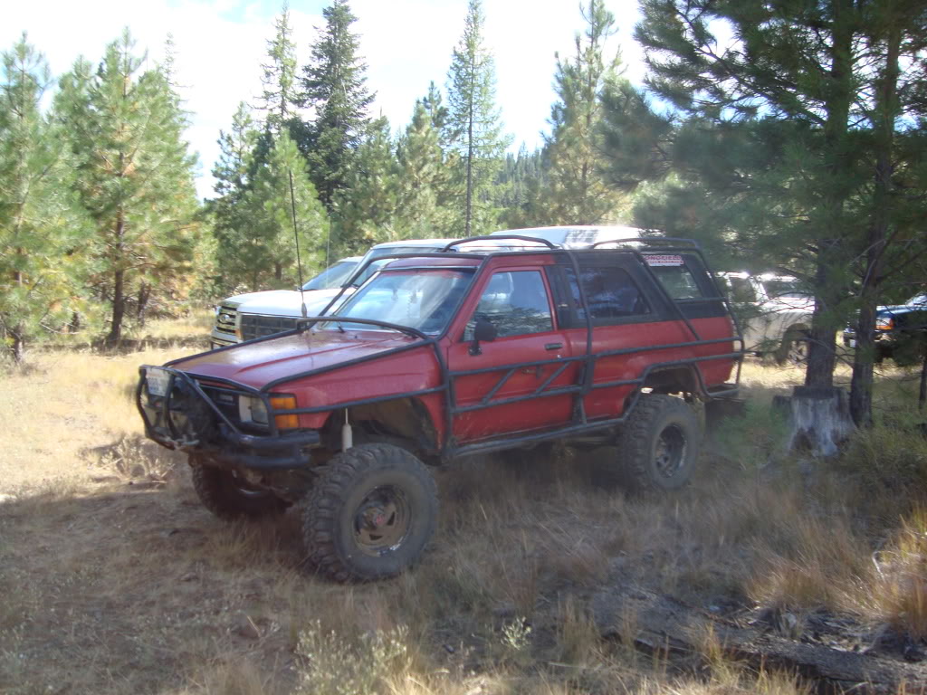

It would be a good idea to upgrade to high steer and a second gen steering box. Post a picture of your 4Runner after you get the lift done. This is my 86 4Runner.

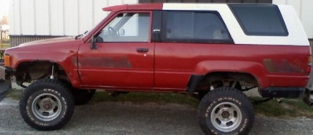

3" Rough Country lift on my 85

Originally Posted by 2003mikem
what type of lift ?
I have 63'' chevy 5'' lift springs in the rear and and trail gear 5'' lift springs in the front, and Bilstien shocks.
Nice looking 4Runner.
