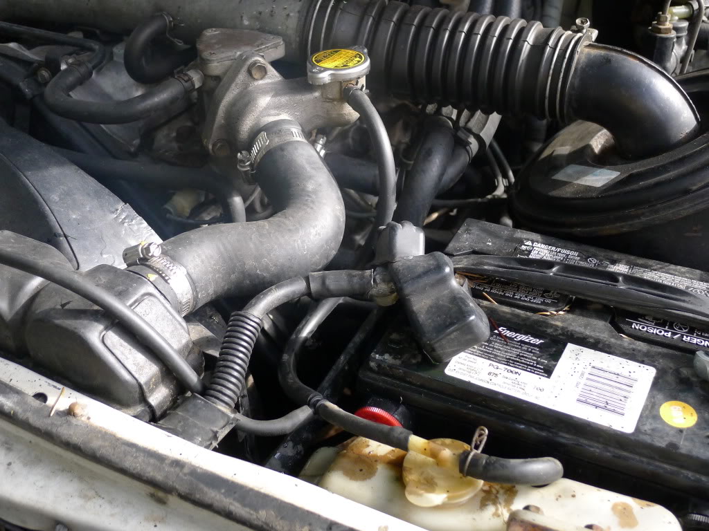

Been reading the mail. I have my son's '85 RV conversion with the 2L-T engine. I drove it back to Seattle area from Denver after he passed away.
One issue was overheating. I later discovered he had the two radiator caps were connected wrong. The main radiator cap was connected to the input of the overflow reservoir and the upper cap was connected to the ourput side. Thus when the engine cooled down the upper cap would suck in air. Had an awful time with overheating in Wyoming and Montana on the way back. Correction seems to be working particularly after burping the system to get coolant through the heater. Parked on an upslope and ran the engine while feeding the upper fill point and watching the bubbles dissipate. System now seems to be working properly and has not seen any loss of coolant. Radiator may just be too small though particularly with the RV body on the rig.

I can't take credit for the RV Rig Daniel. It was originally put togehter by a fellow who sold it to my son David. David had a 78 Chinook he stripped and sold for parts to redo it from the ground up. It was his creation including all the work to paint it with the epoxy paint. I have done some fix ups on wiring and added back some things David took out.
I notice that your engine has a different radiator setup. That radiator has no radiator cap so the only radiator cap is on the thermostat assembly. Here is the was the RV is set up.
Do you have a diesel instrument cluster. I messed up ours and had a tough time finding a replacement. You can get along without one by using after-market gauges. I think it is nice having the pyrometer, boost and oil pressure gauges. Alternator voltage is nice too but only because the rig has an auxiliary battery on an isolator. IF you do install an EGT I will be anxious to hear how your exhaust temperatures read for comparison.

i got the same set up, just not as clean.. if you look at the first pic of the thread its an identical setup.
