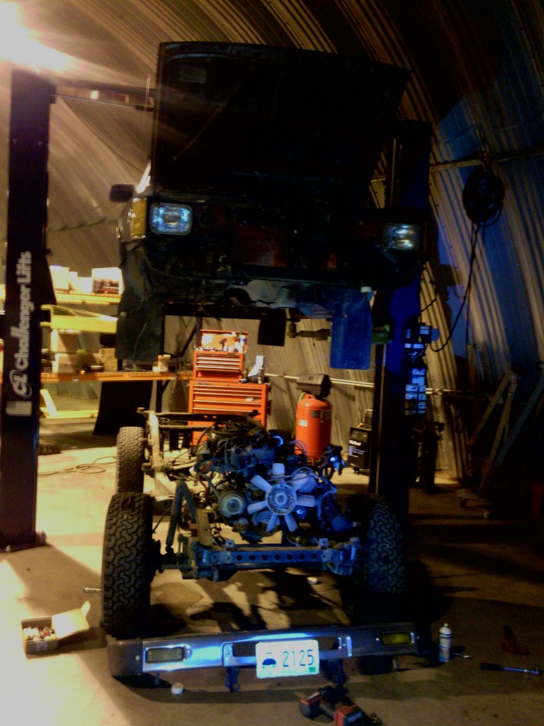

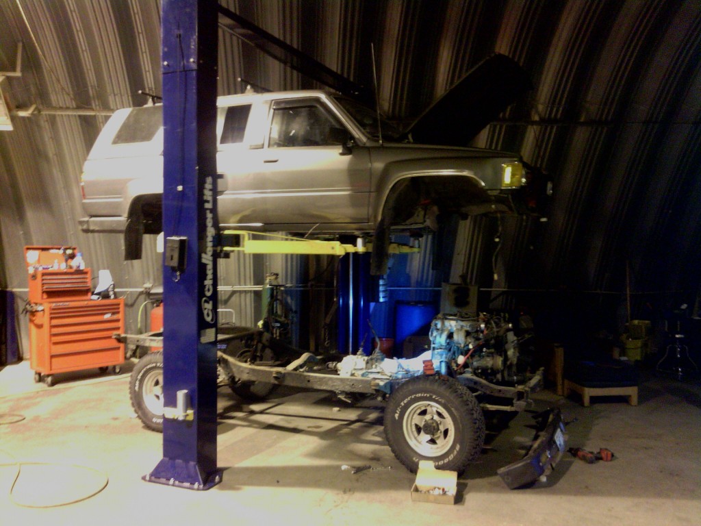

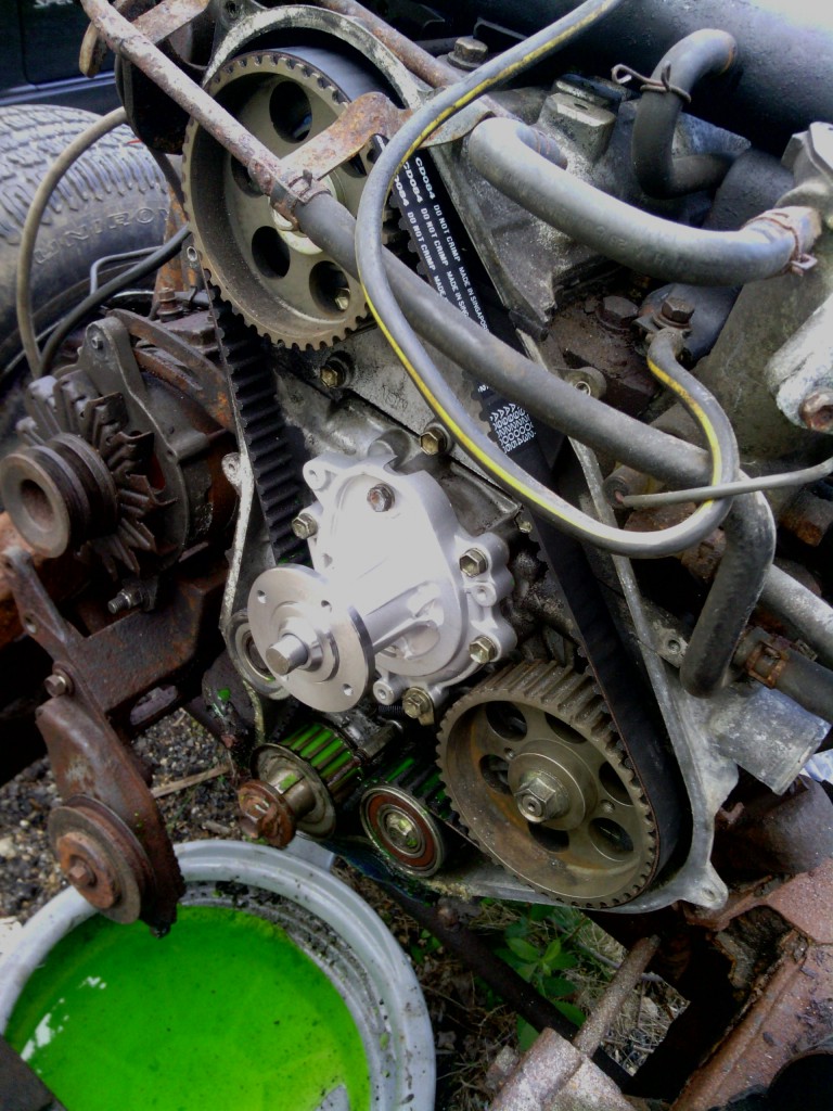

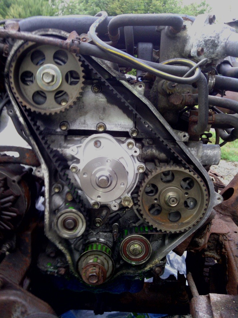

so.. after a few days off, finally got back to work. got the water pump and timing belt installed, no bearings tho. they seem ok but my buddy getting me parts couldnt find em anyway. a few more days later i got started on the 4Runner tear down. hope to get more done this week. iv only been able to work on it after work, long nites.

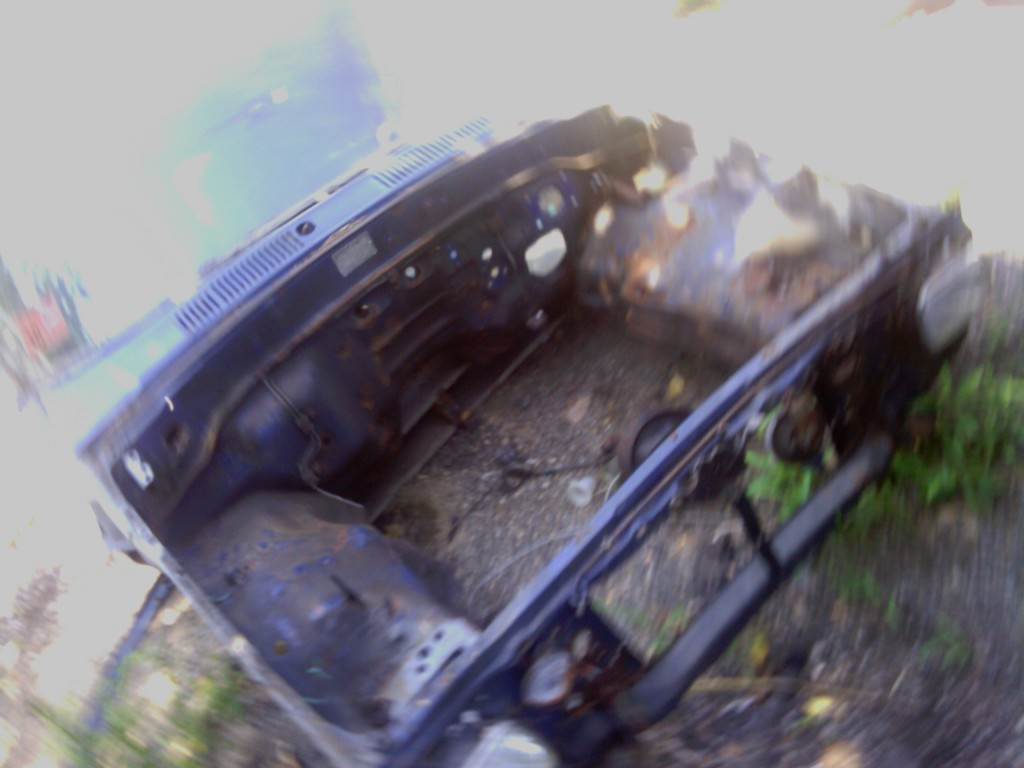

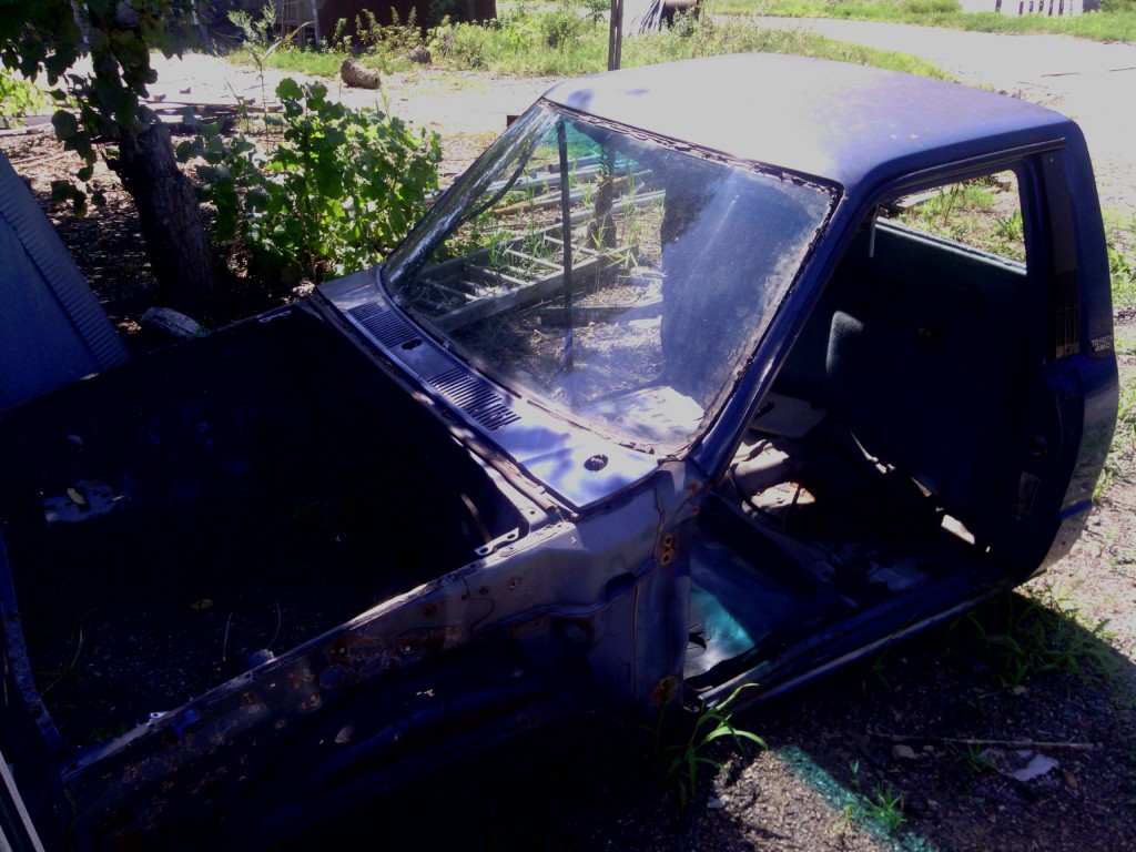

the sad, gutted cab..

sorry bout the crap hole pics

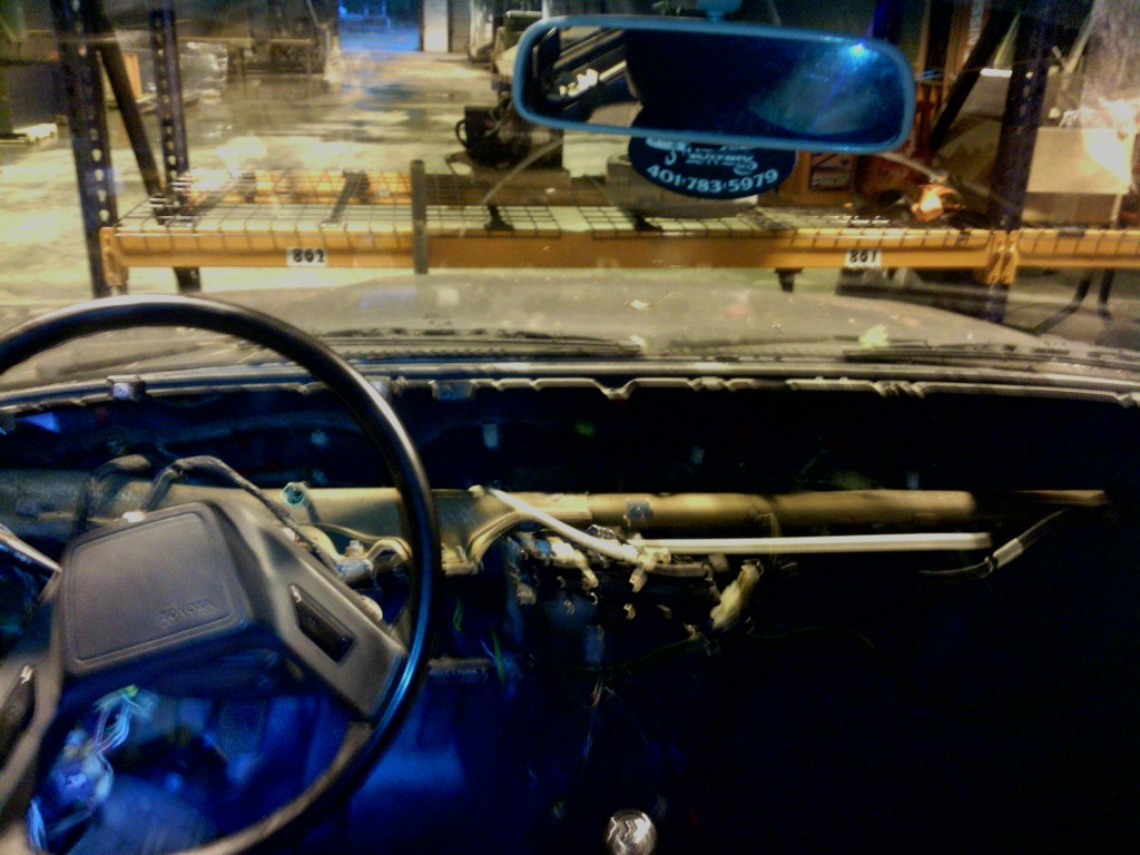

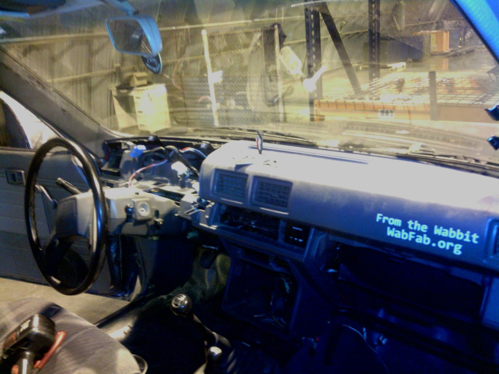

...and finally starting to wrench on the runner. got the dash out, pulling the harness off the firewall. still not sure how im going to wire the rear power accessories for the runner, that the diesel dash doesnt have. probably save that for last.

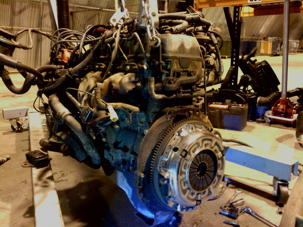

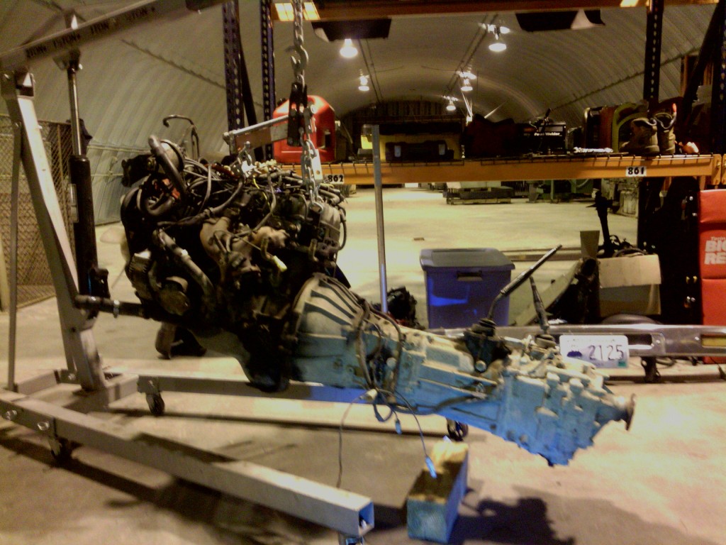

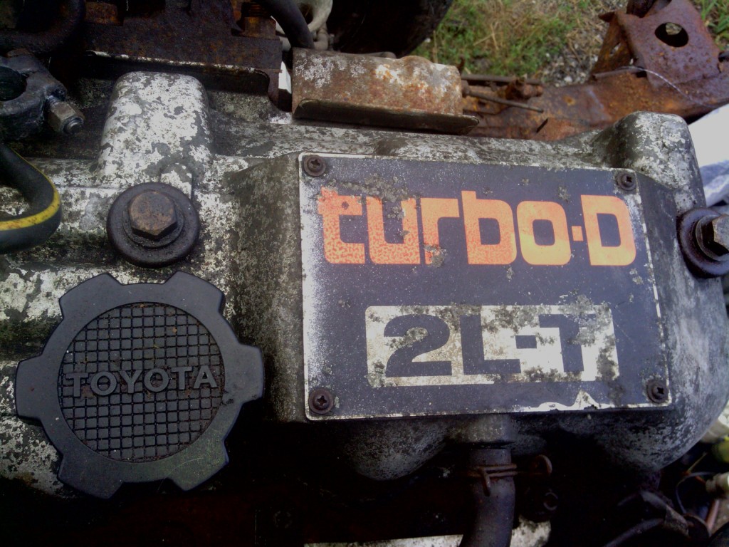

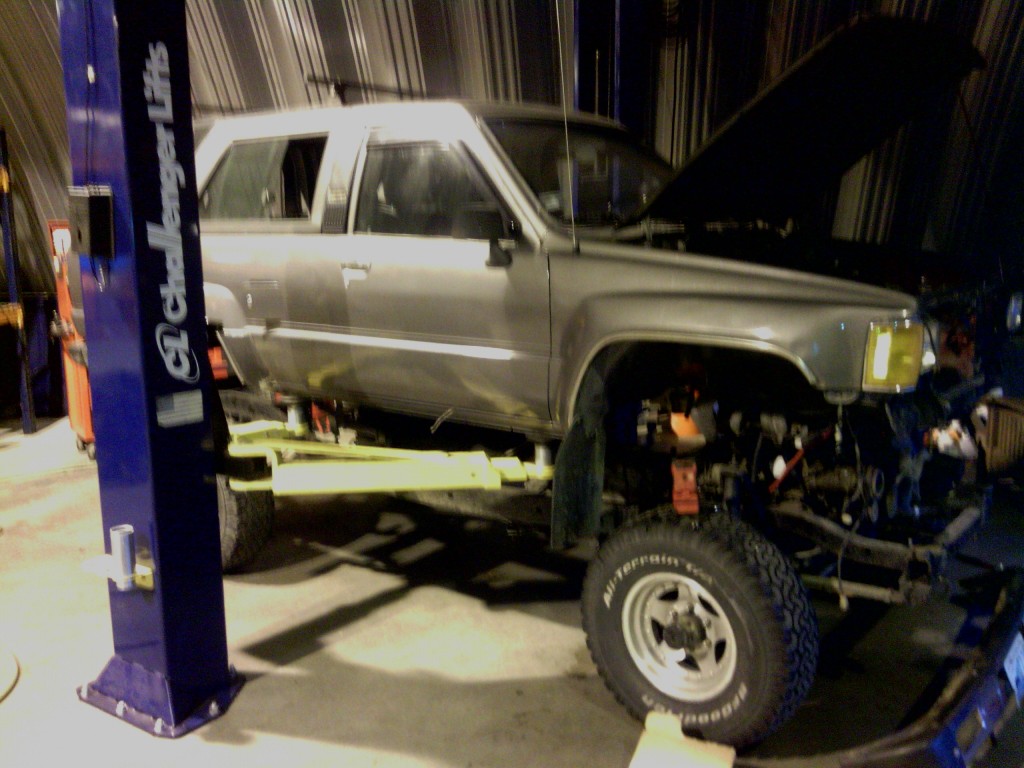

so after over a week or so finally got back to work on the runner. the time i have on the lift is very limited so i had to raise the body and switch the motors in one nite.. man i was tired.
out with the old..
that plate was cleaner then i thought.

i did end up fitting the diesel motor in and lowering the body back down on the frame. the lighting in the shop in crumby in that spot so i didnt bother taking a pic, and i was ready to fall asleep. took a day off from it, ill be back on it tomorrow.
