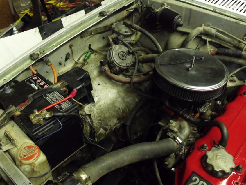

well I found a 22r block on kijiji for $50 so i got him to delive it and gave him 100, came with 20r head and a bunch of parts so i got crackin. using parts from 3 heads and 2 blocks i came out with everthing i used in really great condition. I used a coil and ignitor from an 89 4runner v6 just changed the plugs and put an msd blaster 2 on there. gives be a nice spare that pugs right in if need be. I hope it works. Its all put together but im letting it all dry over night.
I'm really thinking of doing a turbo propane set up. or the 7m single carb.
