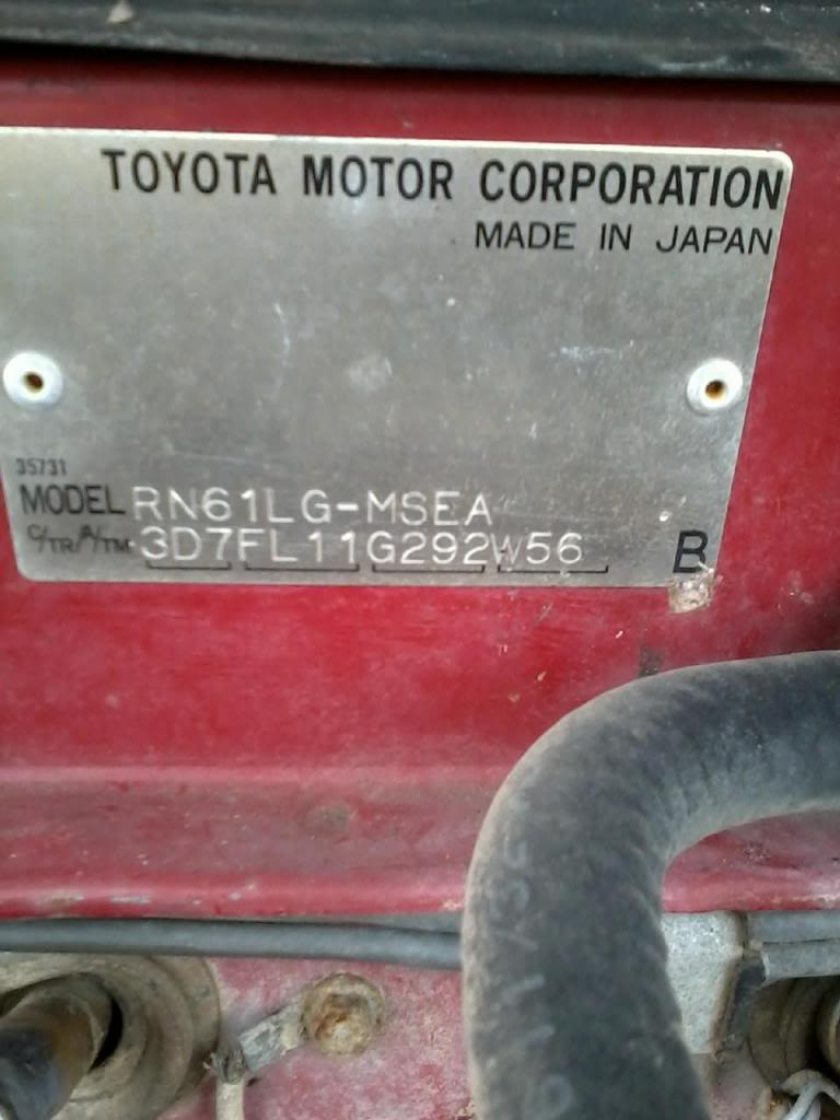

The last 3 digits on the trim tag on the firewall under the hood is what came in the truck.
