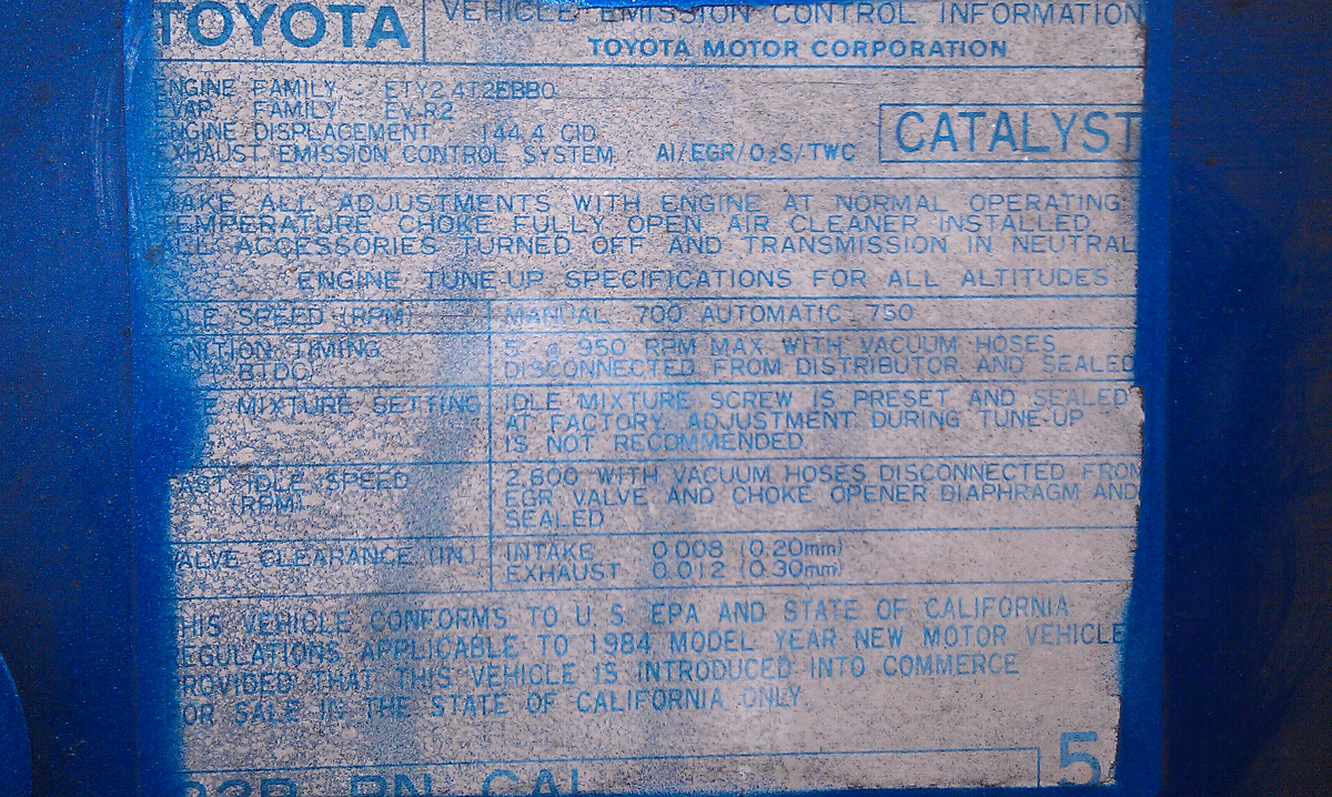

Mine is a 84 pickup and I just go by what's on the truck from the Toyota factory with no problems unless I'm at high altitude and then I just Advance a few degrees and then re adjust when I get back to sea level
84 22r timing, discrepancies in manuals and many forums...-forumrunner_20130131_195354.png
Sent from my ADR6400L using YotaTech

I'll post a pic of my sticker when I can find my other shoe...

The sticker on my '84 Pickup says 5 degrees at 950

I'd have to sign up somewhere to post a pic, suffice to say...it says 5 and it runs like a top there. Just odd that's there's conflicting info.
