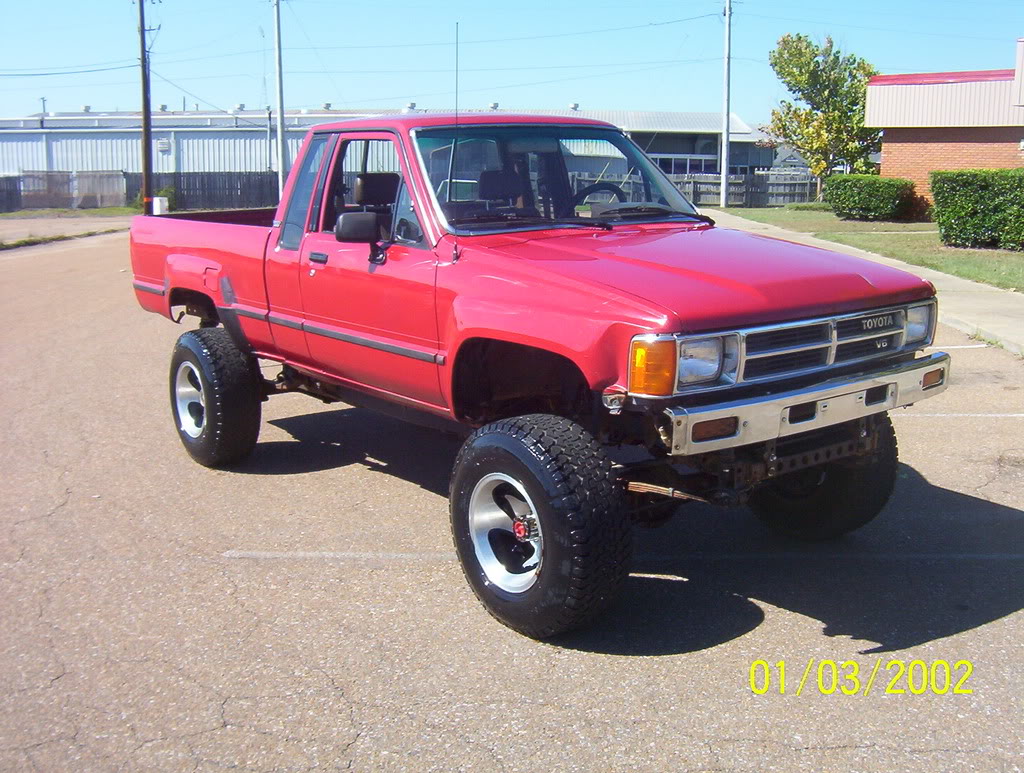

Thanks this is the progress so far 3inch body+2inch shackles with 31x10.50s. Oh please tell me more about the duct tape................
