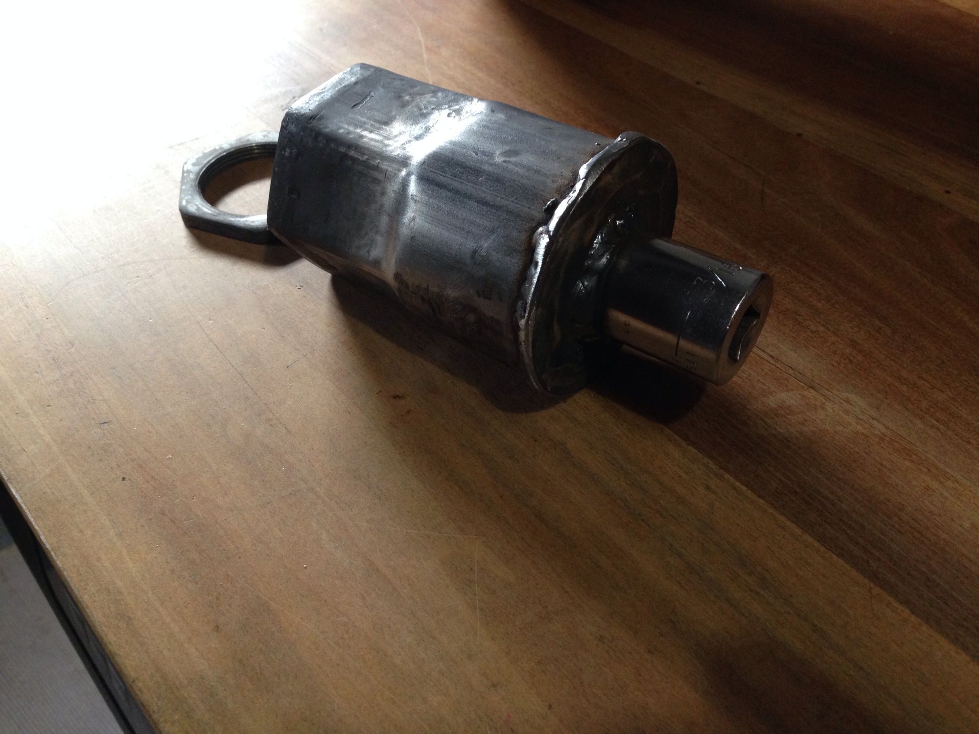

I used my small sledge and massaged the round tubing into a hex checking the fit with the hex washer(and NO I didn't beat it onto the washer while it was on the rig still). Once I had the fit down, I cut a tab at the other end of the tubing and folded it over and using a hose clamp secured it to the side. Cut and filed a nice 1/2" square for a wrachet and viola!! Now that I have a welder, I'll weld the tab down.

Here are some photos of a home made one using 2.5"exhaust tube and welded on large washer and spare 1/2" drive socket. Sorry I haven't figured out how to upload photos here yet. Anyone?
