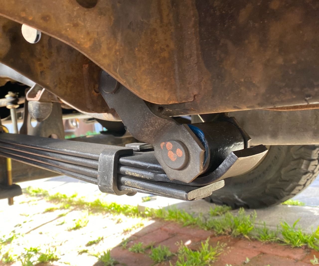

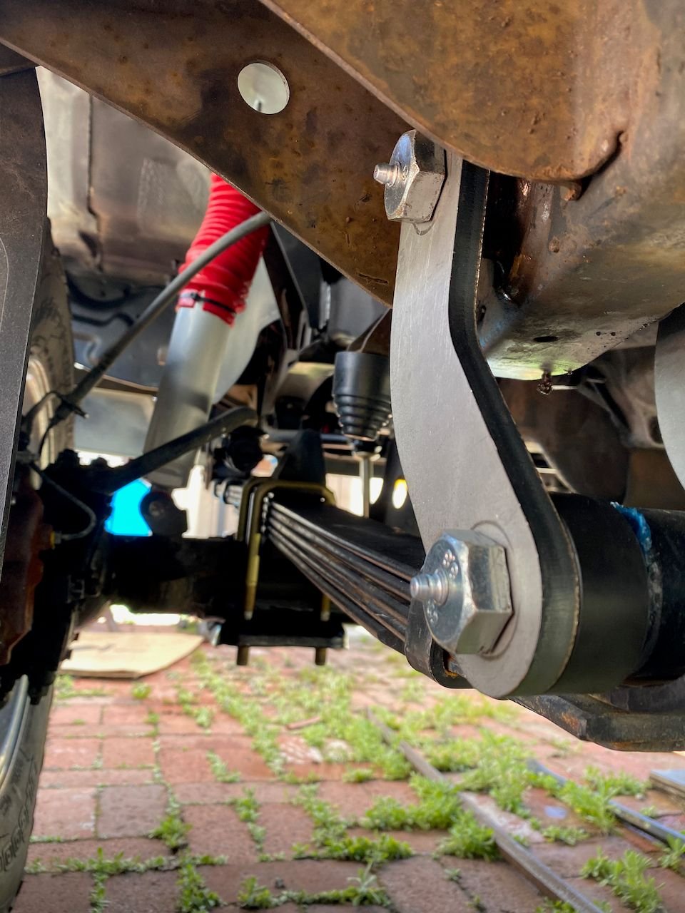

My front springs are junk and replacement Alcan Springs are more than 4 weeks before delivery. The junk springs are so bad the frame is riding on the shackles which makes for a horrible ride.
My temporary fix is a longer shackle from Sky's off-road. https://www.skysoffroaddesign.com/co...ts/toy-bsk-001
Huge improvement in ride quality with the shackle working as engineered.
Remains to be seen if I'll use them after I install the Alcan Springs.
