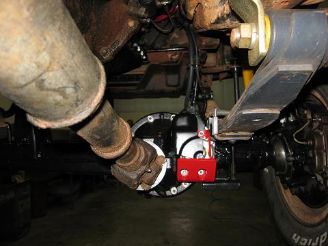

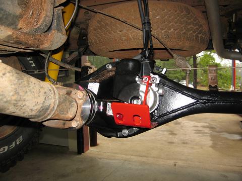

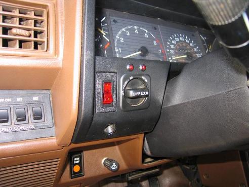

No way would I use one of those silly Downey cables. They are wired with an FZJ80 elocker ECU and switch....took me a while to figure out the wiring but it's fantastic. The only disadvantage to this route is you cannot lock just the front. It's either rear or both but that's fine by me.
Pics...

No, they are 4.56. You can buy the TRD elockers in 4.10, 4.30 or 4.56. It's kind of nice to have everything set up from the factory with a 1 year warranty. Unfortunately the Hi-pinion elockers (93 to 97 FZJ80 models) only come from the factory in 4.10. Otherwise I would have gone hi-pinion in the front.
No elockers, to my knowledge, were or are available in 4.88.
