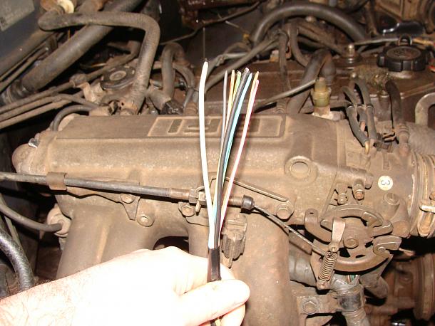

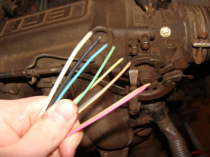

Hey guy, im doing a 22r to 22re swap in my truck and the wiring harness i have is an auatomatic one and my transmition in a manual so i know that i have to put a jumper on the neutral switch.. so what i did was cut the harness that goes in to the shift box on th auto transmition and i plugged it into the my wire harness the idea is, is that if i jumper these together it should work, problem is i dont know which wires go where so i was wondering if someone has done this before and may know where they go.. i will post a picture of what i am talking about when i get home later. thanks for any help guys...

these are the wires

i figured it out for those who would like to know its the two biggest wires the black and white
