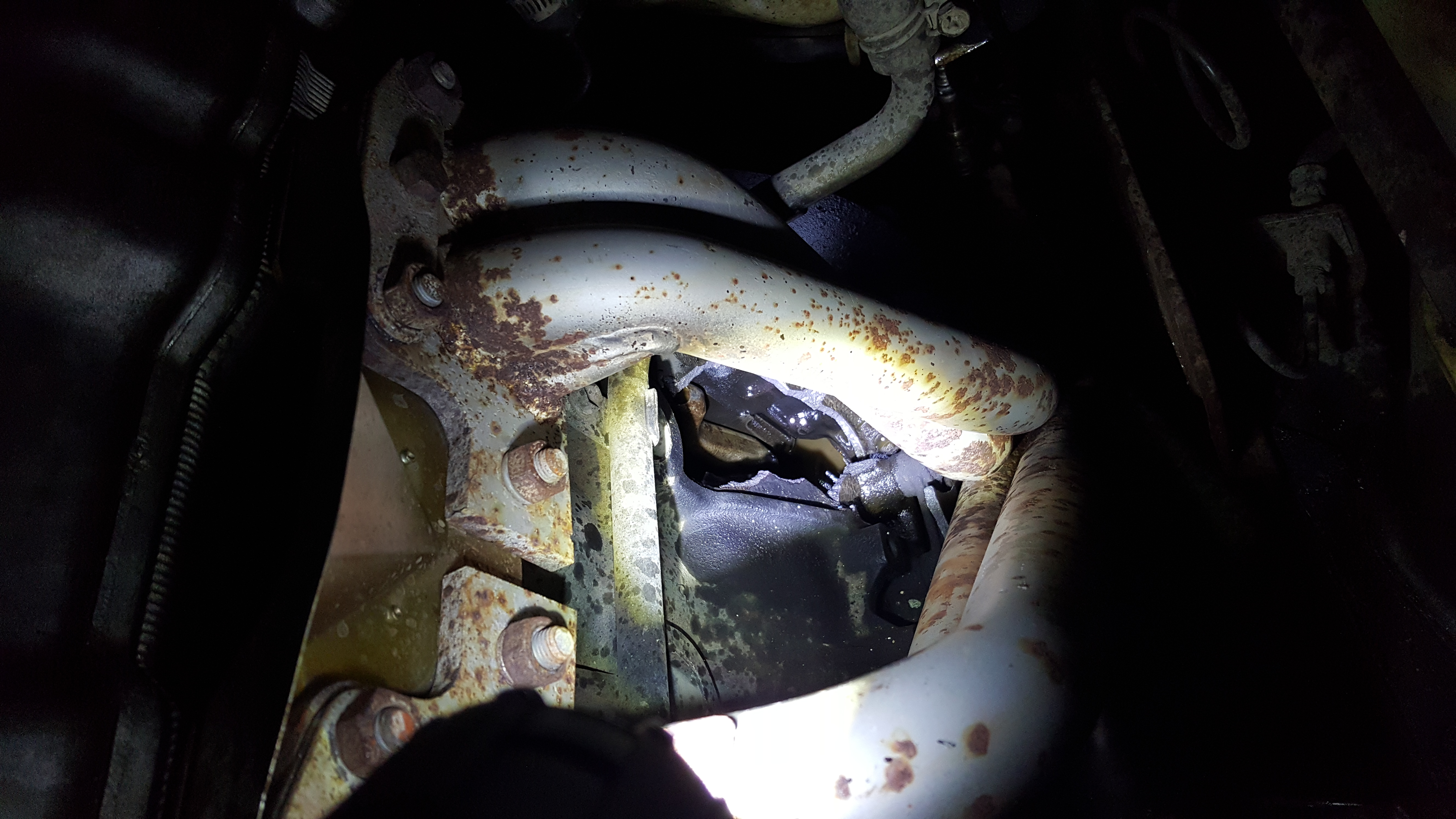

Hello, sorry newbie here so hope this is an ok section to ask this in. Ive got a 1985 toyota pickup that decided to throw a rod through the engine block last night. Im looking for a rebuilt or new short block since I have an eng bldrs head and cam thats only about 8k old. I wanted to see if you guys had any suggestions of what companies put out a good short block or which ones to stay away from. Im looking at a bugdet of around 1500. I have considered finding a used 22re and rebuilding it but currently dont have much spare time or a good location to rebuild it at. I like the 22re and for simplicity sake Im planning on putting another one in even though a v6 swap would be nice I just dont have the ability to do that right now.
