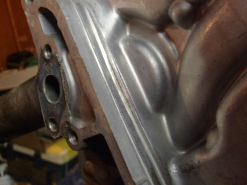

Update:
For anyone who searches and finds this...
I found the culprit. If you look close you can see the crack that formed where the chain wore into the timing cover.

All too common now that I've read up on it. The 4runner had 225k on it, I wouldn't be surprised if the chain was only changed once.. maybe the original chain?
