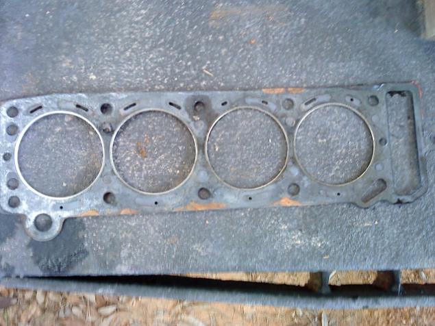

should i see a big tear or something?????

That gasket didn't look too bad to me at all. Not sure if you checked the timing cover for wear. White smoke would usually mean coolant or rings guys, no? Did you have the head checked for warping?...do another compression test? The cleaners you used DO cause quite a bit of white smoke, and they can take a while to work out, maybe 20 minutes of driving on average, give or take? If it's fuel, I would think your plugs would be black after not too long, smelling like fuel as well. Rich is usually black smoke, as far as I've learned.
