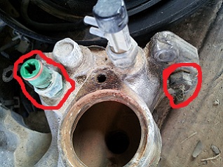

Ok i am looked and looked i seen people ask but no one ever sayin what it goes to or what they are. Here is a picture of my 22r intake manifold off my 1985 4cyl and i took it off tryin to get rid of the valcume lines and i was seeing what the 2 things are cirlce in red. I couldnt find them in my repair book

According the FSM those are thermal switches. So I would guess there part of the emissions equiptment on the engine.

The one on the right is for the stock in-dash temperature gauge.
The one on the left is one of two temperature sensors/switches. That one (yours) has the green round connector. The other temperature sensor/switch, which would be mounted right next to it where that metal plug is, would be a green square shaped connector. I would assume since you are in Texas that you do not need the second square temperature sensor/switch. Me being in California, I have both. I'm at work so I can't look up what this particular sensor does or is used for, but it signals when the coolant temperature reaches a certain temperature. Both sensors signal on two different temperature readings. So it's not like they are interchangeable. If you needed the round one but all you you find was the square one, and you used the square one in it's place, it would signal an erroneous reading.
One is still available from Toyota new (or at least when I bought it new when I replaced my engine) and one is discontinued. One is called temperature switch or sensor #1, the other is called Temperature switch or sensor #2. The FSM shows has to test this sensor/switch.
Thank you so much on here is the other question. I just bought an offy intak manifold and i gettin rid of all the emissions stuff since the truck is an off road mud bogger will i only need to hook up the one on the right?
and yeah it has the green round plug do i have to have it hooked up?

To monitor the internal engine coolant temperature than most certainly, yes. Or you can do an aftermarket temperature gauge. I went aftermarket when I installed my new engine as I did not trust a 25-year old dash gauge.
edit to add... I should mention that the one on the right works totaly independent of the engine. The engine, or computer if you have one, does not need that sensor. That sensor only tells you, the driver, what temperature the engine coolant is at.
Now that question will have to wait until I get home to see what it specifically does. I'm at work so I can not look it up. Maybe someone else here will chime in until then.

What I have found so far is that one sensor you have is part of the "Fuel Evaporative Emission Control" (EVAP). And it's called Temperature Switch 1.
It looks like even the 49-state (Federal) vehicles have some version of a computer control emissons system.

should be the temperture control for cold mixture heater that is on the bottom the the factory intake manifold. as the engine get to operating temp the sensor will open the circuit to the heater element. helps with cold start operation by helping fuel vaporize.
