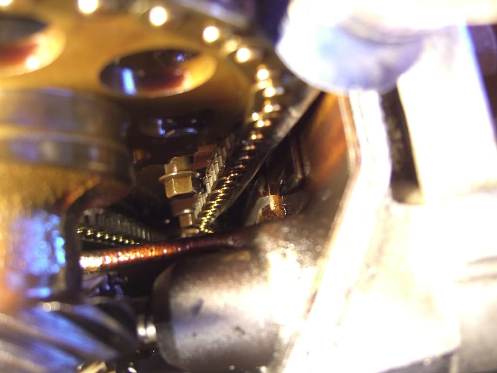

i would also replace your timing chain and tensioner when you have her torn down, my tensioner broke on my 22re and the chain was slapping around the inside of the block until it wore a hole that aloud all my coolant to drain into my oil pan. PITA
Old Apr 5, 2012 | 05:29 PM
AJ Tarnas's Avatar
Joined: Mar 2012
Posts: 40
From: Pittsburgh PA
Yep, I got engnbldr's "front end kit" -- my driver-side plastic timing guide is broken, but I haven't taken off the cover yet so I don't know if there's any real damage. If your chain created a hole in the block... was that engine block finished?

no. the chain will rub a hole in the timing chain cover. that piece is included in engnbldr's kit.
the grooves (silver-ish) are not in the block:
