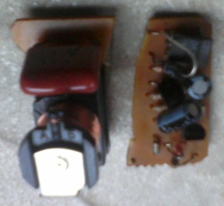

This part plugs in under the inside drivers side door fuse box panel. I broke mine and need a new one but don't know the name of the part. Can anyone help by identifying the part? Thanks

that is a turrible picture...

Looks like some kind of relay. Check the FSM.

A fewrelays that come to mind... Charge Light Relay, Parking Light Relay, maybe the EFI relay... and a flasher. Zoom out so we can see the location of the broken component. Toyota labeled most of those relays, there should be print above or below where the relay plugs in.

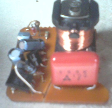

i will post better pictures of the piece.. i only have two parts and am missing the plug part- which is green.

better pics

Ashley, look familiar?
What you're looking at is a Nippo Denso turn signal flasher relay used on 1984-1988 Toyota trucks/4Runners (and most likely other years). It causes the turn signals to "blink". Facing your interior fuse panel, it plugs in on the bottom left corner of the fuse panel. It looks exactly like the pictures you have, just that some of the PCB components on yours are leaning. Probably because its been mounted without a case. The green "chicklet" looking component versus your red one shouldn't mean anything. I think its just a matter of what color soldermask the PCB constructor decided to use on that work shift.
You could easily find one in your area at a junkyard or autoparts store, but if you have trouble getting one (or live in Northern California) I've got spares laying around.
This might not be it though, broken turn signal flashers typically don't cause all of the electrical gremlins that you've listed and flashers are easily confused with other types of relays. 22R or 22RE?
