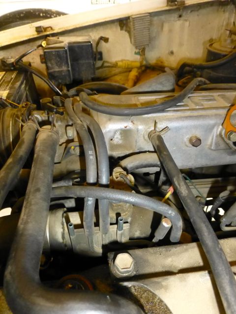

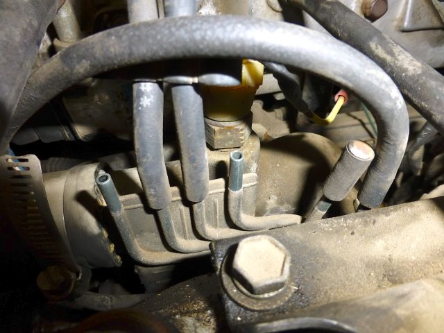

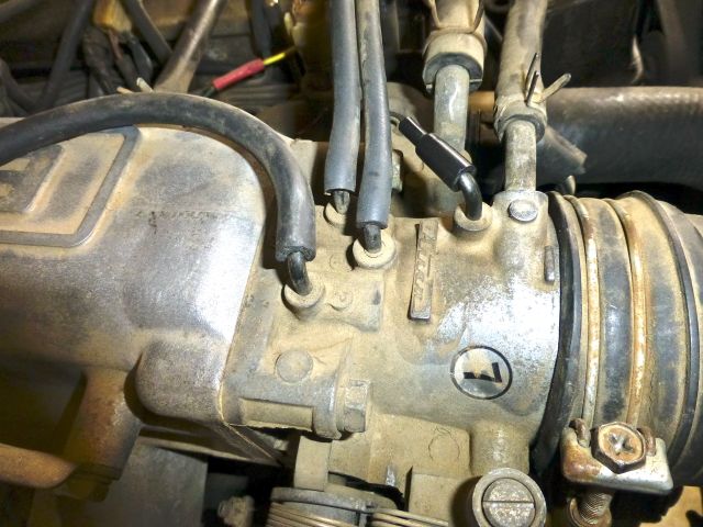

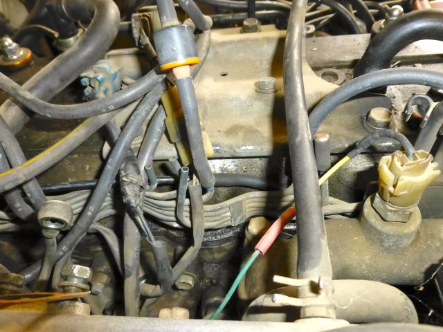

The first picture shows the vacuum connections on the throttle body (3 with hoses, one with plug on it towards the front)
The other two are focussed on the group of nibs at the middle of the valve cover. Notice the cap on the one to the right (piece of hose with a screw in it)

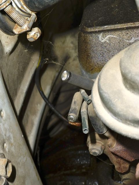

The first one here shows the connections (or lack of connections) adjacent to the firewall. Two of the nibs have plugs on them (piece of hose with screw in it)
The next two pictures are looking back towards the passenger side of the pickup. On the left you can see the plugs that were referenced in the previous set of pictures.

it appears that you have the later model 22re intake manifold and throttle body, because it's straight instead of pointing down... that is good, I just can't recall if the vacuum diagrams are exactly the same.
whatever it is, I passed ca smog with the same thing that you have... if you are in ca, that smog cert is only good for 3 months.

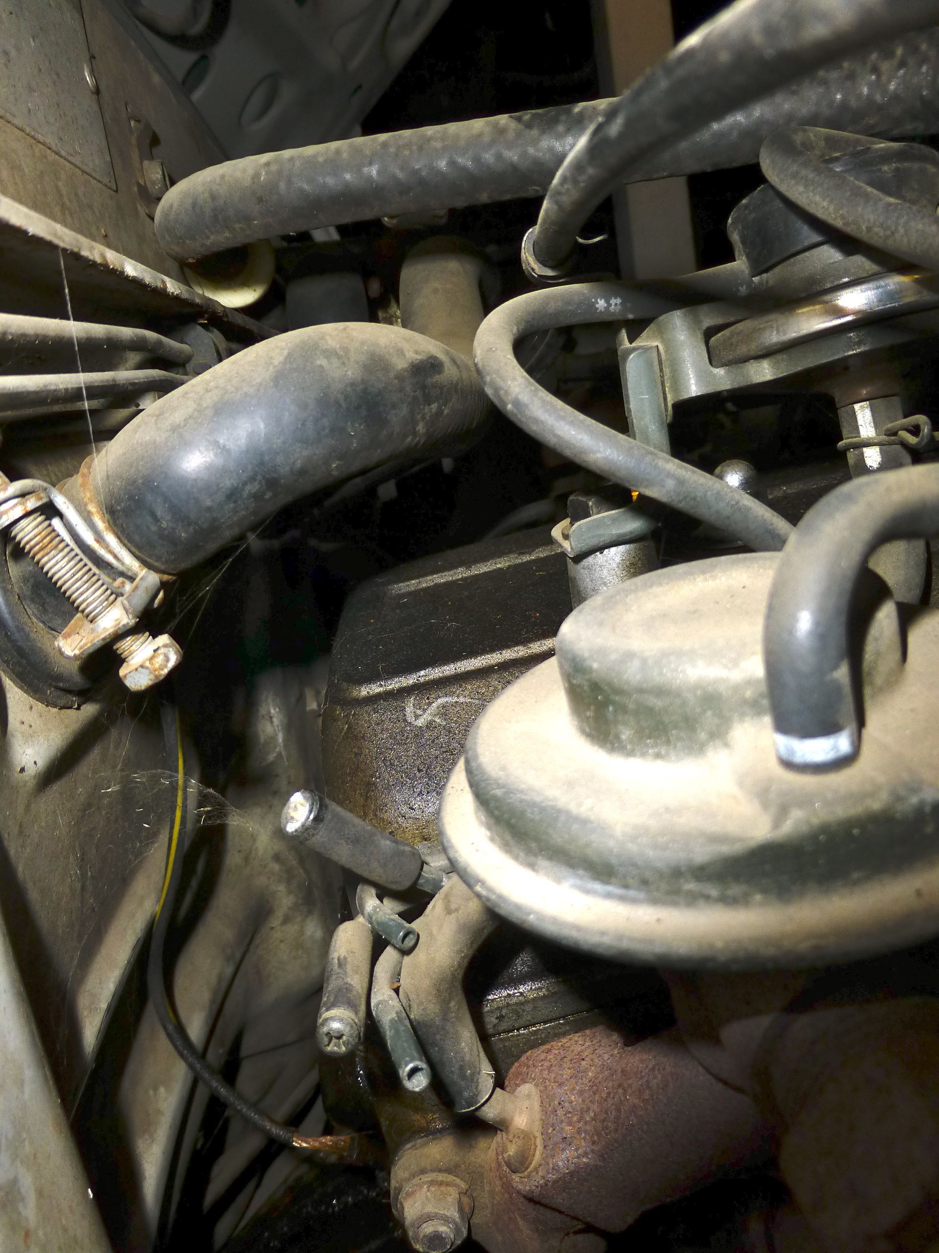

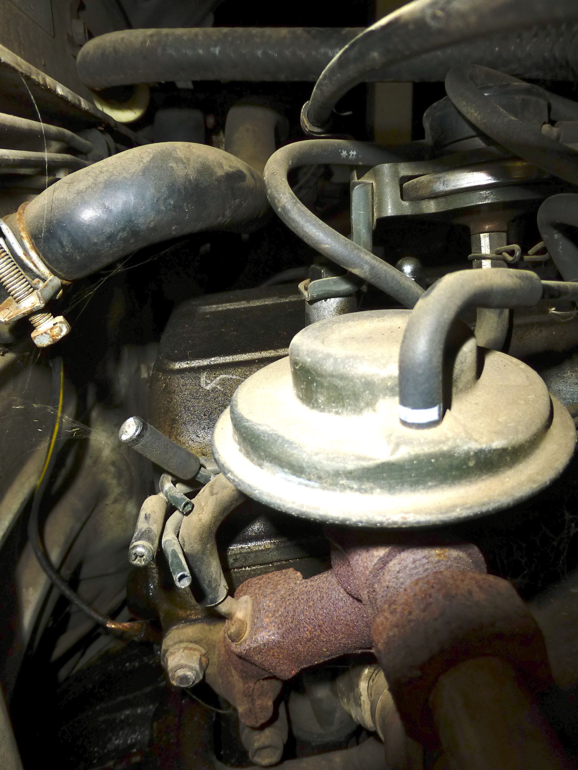

Here are a few pics from the area to the back of the valve cover by the EGR valve.
(I spent two hours today hitting various parts houses in town trying to find the same ID/OD vacuum line, and finally have a 6 foot length in hand.)
it looks like hoses are hooked up back there, but also much is unplugged... i'd look at the hose diagram for, say, a 1991 22re, and see if that covers it.
in order to pass smog, the hose routing usually has to match the hose diagram sticker under the hood, so that may be the way to hook it up... for the next smog, you may have screw that idle speed controller back into the intake manifold, where the square plug is now.
Here are a couple shots of the EGR valve from the side. I'm making a wild guess that someone essentially disabled the EGR for some reason. Perhaps it was not working right. But these lines have definitely been disabled.

it was probably removed before you got the truck... it screws into that hole that's plugged, right next to the cold start injector.
if I recall correctly, my '86 22re doesn't have those hoses coming out behind the egr valve, in your last pic... notice how the small hoses are all plugged into that bank of metal tubes? that bank can be pulled off of the engine, it's held in by a couple of nuts, I believe.
there appear to be at least seven metal tubes in that bank, but your '85 doesn't need all of those tubes(?), and you don't want them left just opened up for the smog guy to question... look at the diagram that terry posted, it only shows four metal tubes, not seven... there are seven tubes there because that's a later model 22re, which is good, because it has the straight intake manifold, which includes a far superior cold start warmup function... as an aside, the later model intake system may not have the same brown vtv listed in terry's pic.
remember, the object is to make this late model hose routing match an '85, not the later model that it is, because of smog laws... my thought is, remove the metal tube back, maybe cut off the top metal tubes that you don't need, or go to the junkyard, and get the right year metal tube bank, along with that missing idle speedup controller, that screws into the intake manifold... you need the latter because it gives you a place to plug in some of those hoses coming off of the intake throttle body.
hook your truck up by the diagram under the hood, that's what the smog guy will go on.

The PO did a poor job of disabling the EGR. The EGR is another thing that seems to hang people up on California emissions. They possibly disabled it due to the carbon mess it creates inside the intake system. I suggest hooking it back up to the way that it should be with all of the vacuum lines hooked up to the way that it should be. If you want to keep the intake system clean, after passing your emissions test, you can put a plate in between the EGR tube and the Plenum. This will keep you from getting any check engine lights.
I am neither for or against the EGR, as these motors have ran high miles with it hooked up. I have read how in some ways that it does help cool the motor in a long round about way. I am currently running one of my trucks with the EGR hooked up and one with it disabled for my own little test. I will say that every 22re truck I have worked on, none of them had a fully functioning EGR due to the carbon build up in them.
I will try and post some pictures that might make it a little easier for hooking up your lines to the EGR.
