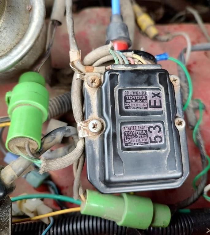

that 53 ex igniter is also used on the '86 22re, it's been OOS for quite awhile now, here is a list of equivalent part numbers i posted, that you can also search for: https://www.yotatech.com/forums/f116...-motor-305381/
i put in a stock notification at rockauto and one finally came up, so i got lucky... at the minimum, i'd suggest that everyone get a junkyard backup while they are still available.
i tore my dead 53 ex apart, it's not a rebuildable item.
