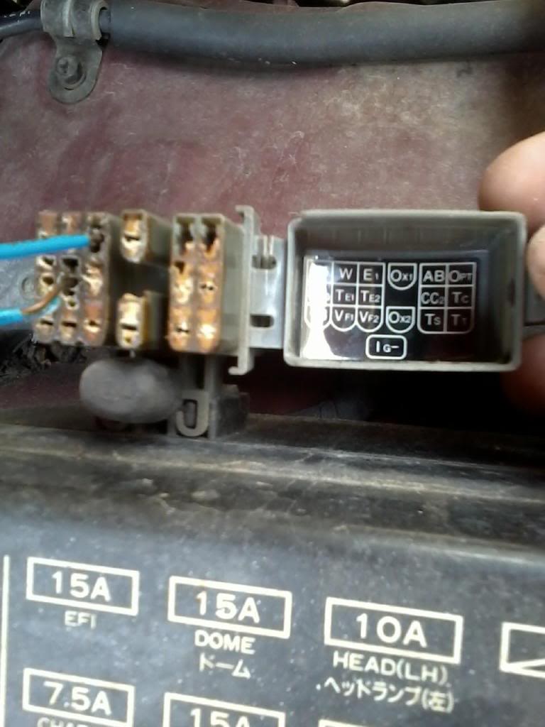

How to get Check Engine Codes. I just put this up for others. Applies to 87 and up. 86 and older is the bottom picture. TE1/E1
The Diagnostic port for the 85-86 is on the Drivers side inner fender and is nothing the same as the 87 and up. Here is T1 and E1 jumped. The codes and engine flashes are the same as the rest of the trucks on the dash.

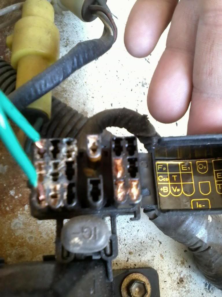

Here is how you do a Fuel Pump Bypass on the 85/86.
Jumper wire the Yellow Plug on Drivers side. ( Jumper wire should be in both contacts for testing, I just didnt have it in for picture purposes and mostly a referece for me at a later time.)

thanks for all the info. I will remove speaker and examine relay. my error codes flash when key is on. do I still need to put in jumper?
