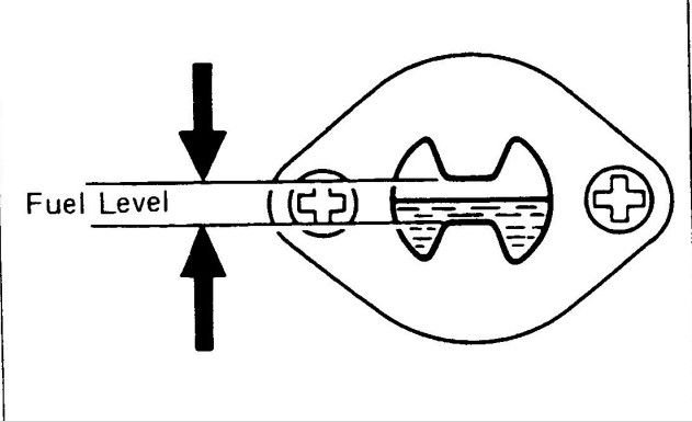

I haven't replaced any more of the fuel line(s), but did replace all of the 1/8" vacuum tubing with Toyota brand tubing. (FYI, the fuel line on my model is 1/4" I.D.) No change in how it runs. When engine cold, it runs a lttle rough, but not too bad. Within driving a few miles and as engine warms up, the "bucking" will begin. The fuel level at the sight glass is correct.
