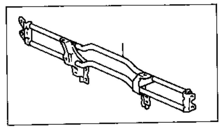

I also have not found anyone offering the tubular backing (bumper stay?) for the front bumper for any of the 85/86 trucks. Just the mounting brackets that are welded to the steel tubes. My tubular portion is salvageable but rusted thin and the mounting brackets are crushed. I don't know if the aftermarket replacement standard mounting brackets will work for the 1 ton. There were apparently 2 different versions of the bumper stay. One with simply curved tubes and a version with 2 bends in the middle area. Mine are the type with the 2 bends in the middle portion. My 85 had the optional rubber bumper guards on the front face bar mounting bolts.

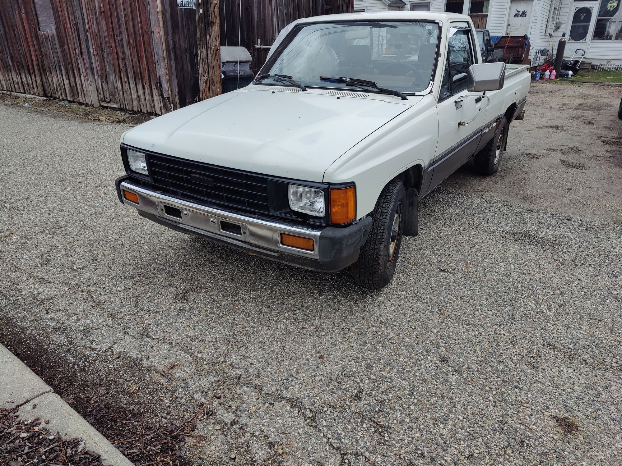

Here is a photo of the 1986 1 ton followed by the style bumper stay that is used.
1986 1 ton with Hella E code H4 headlights.
This is the style reinforcement/bumper stay used on the 1985/86 1 ton.
