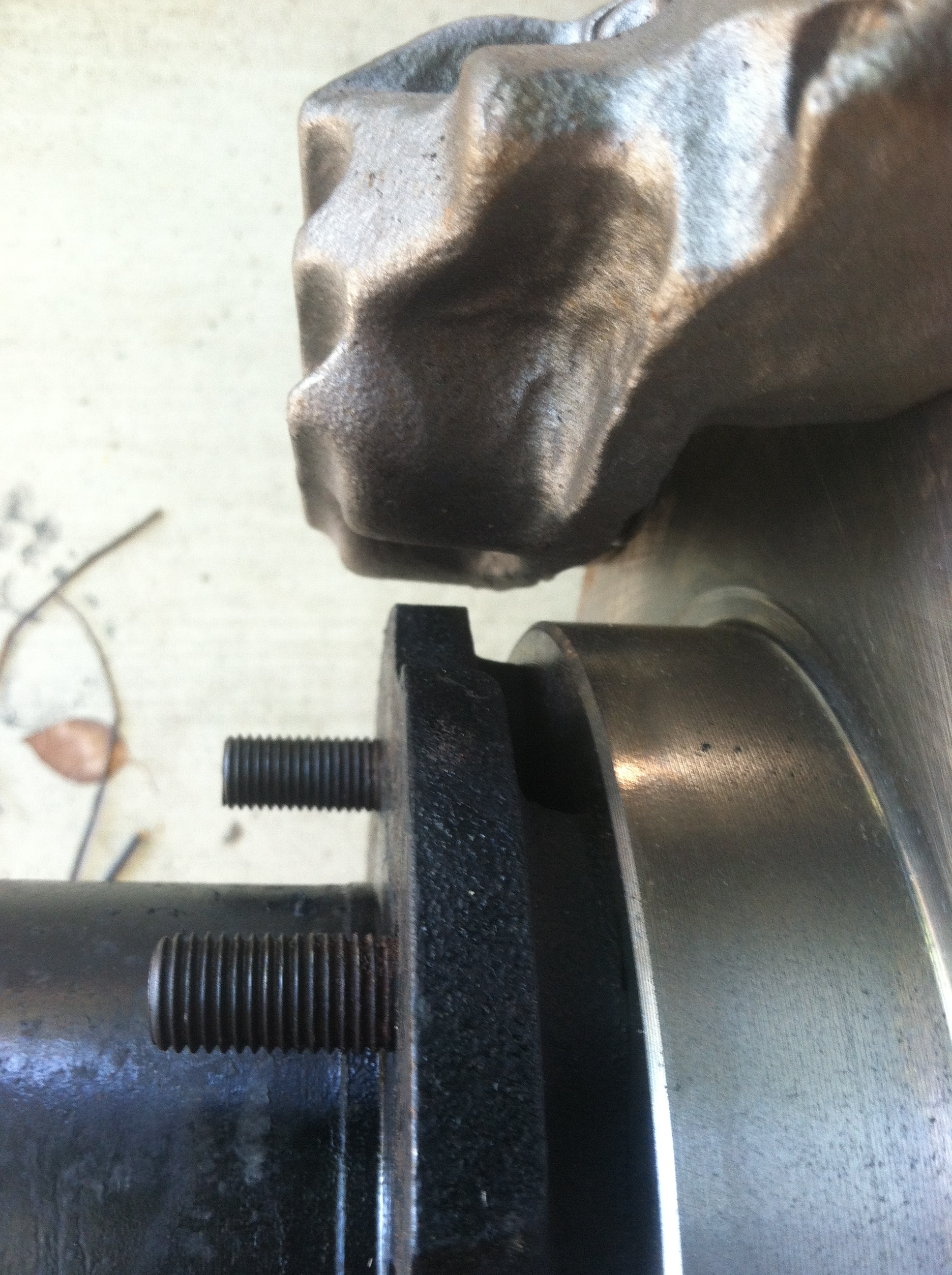

I recently finished the v6 caliper/fj rotor upgrade on my 85 SFA 4runner and current 15x8 3.75" bs wheels will not clear the caliper face. I knew this would most likely happen after reading through the forums.
I would rather buy new rims then run spacers on the front. I've read through explanations about backspacing and offset. My question is if my calipers extend out 1/2" would I need wheels with a larger bs like 4" or do I need a wheel with enough negative offset about -13mm, which as I understand would create a larger "dish" to clear the face of caliper? I have to order rims to test fit and need to know exactly what I need.

I just run 1.5" spacers, which matches the IFS rear I put in.
Any particular reason you don't want to run spacers?

People seem to be split 50/50 on spacers. Some love them and some hate them. My rig is my DD and I wouldn't mind putting some better looking rims if I could find them for $50-$70 a pop but the more I look and ask around it seems the grinder, spacers or both.
I take it you like your spacers? Did you ever run the spacers before your rear was done and if so did you notice anything different like the tracking of the truck or wear of the tires? I have the TG spacers in my shopping cart but am hesitant to pull the trigger just yet. Even if I don't have the IFS rear, would you recommend the 1.5" spacer? I would like to do the conversion but it would be a while before it gets done.

there's no reason to be scared of running spacers, if installed correctly you should have no problems.
