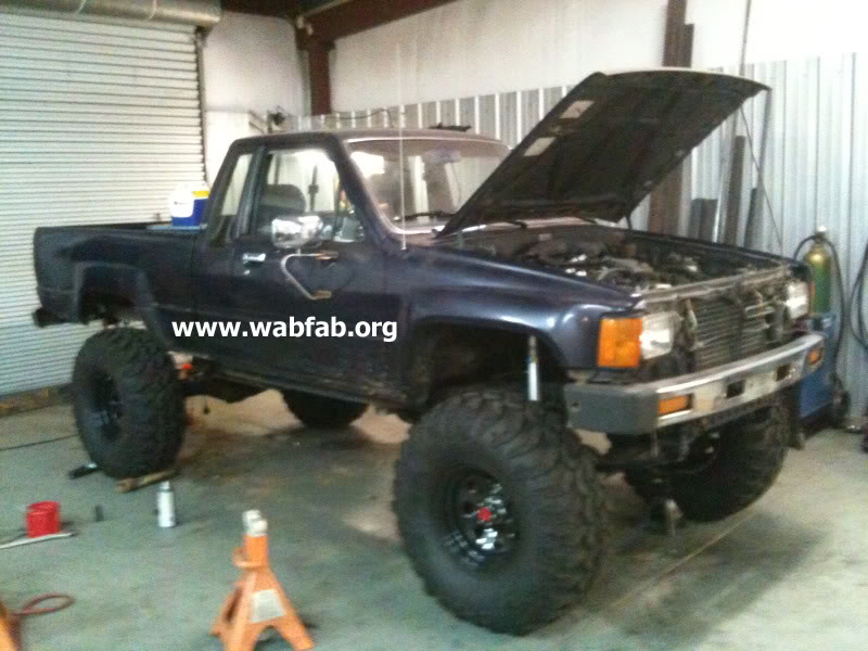

https://www.yotatech.com/forums/f198...barney-188749/
:wabbit2:
