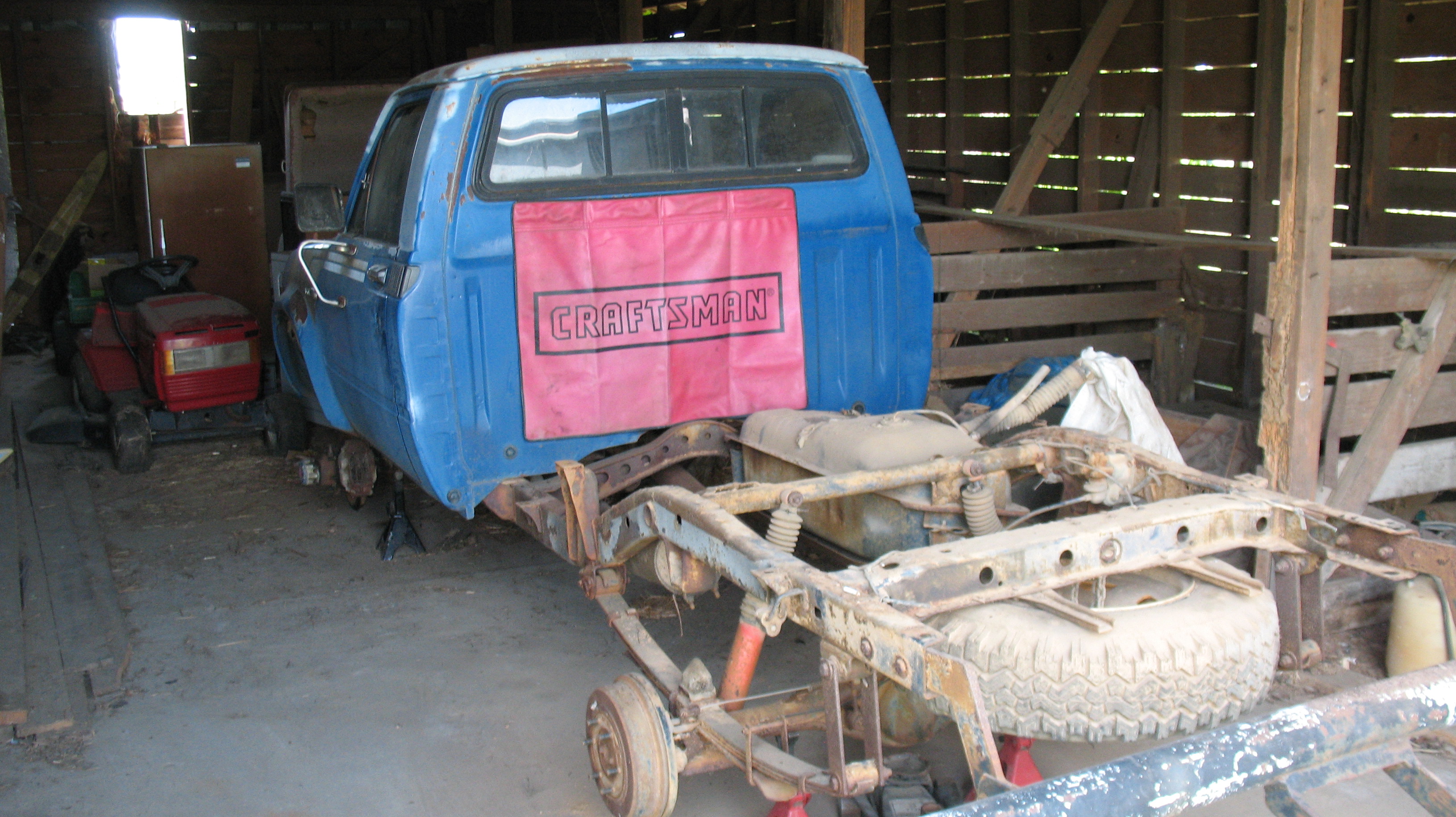

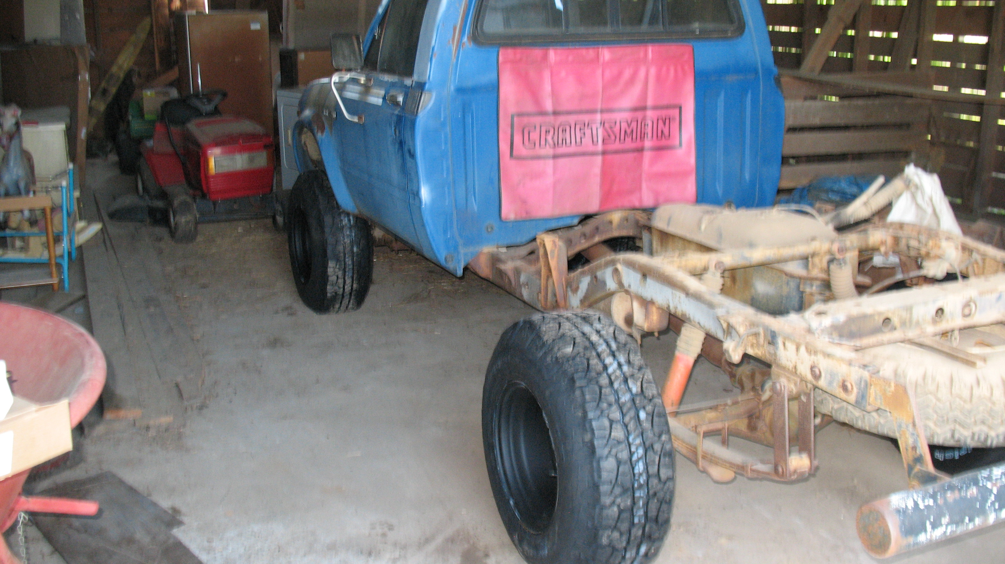

a few pics. maybe this will work.
Attached Thumbnails Whats up? new here. got a new toyota-img_0794.jpg   Whats up? new here. got a new toyota-img_0795.jpg

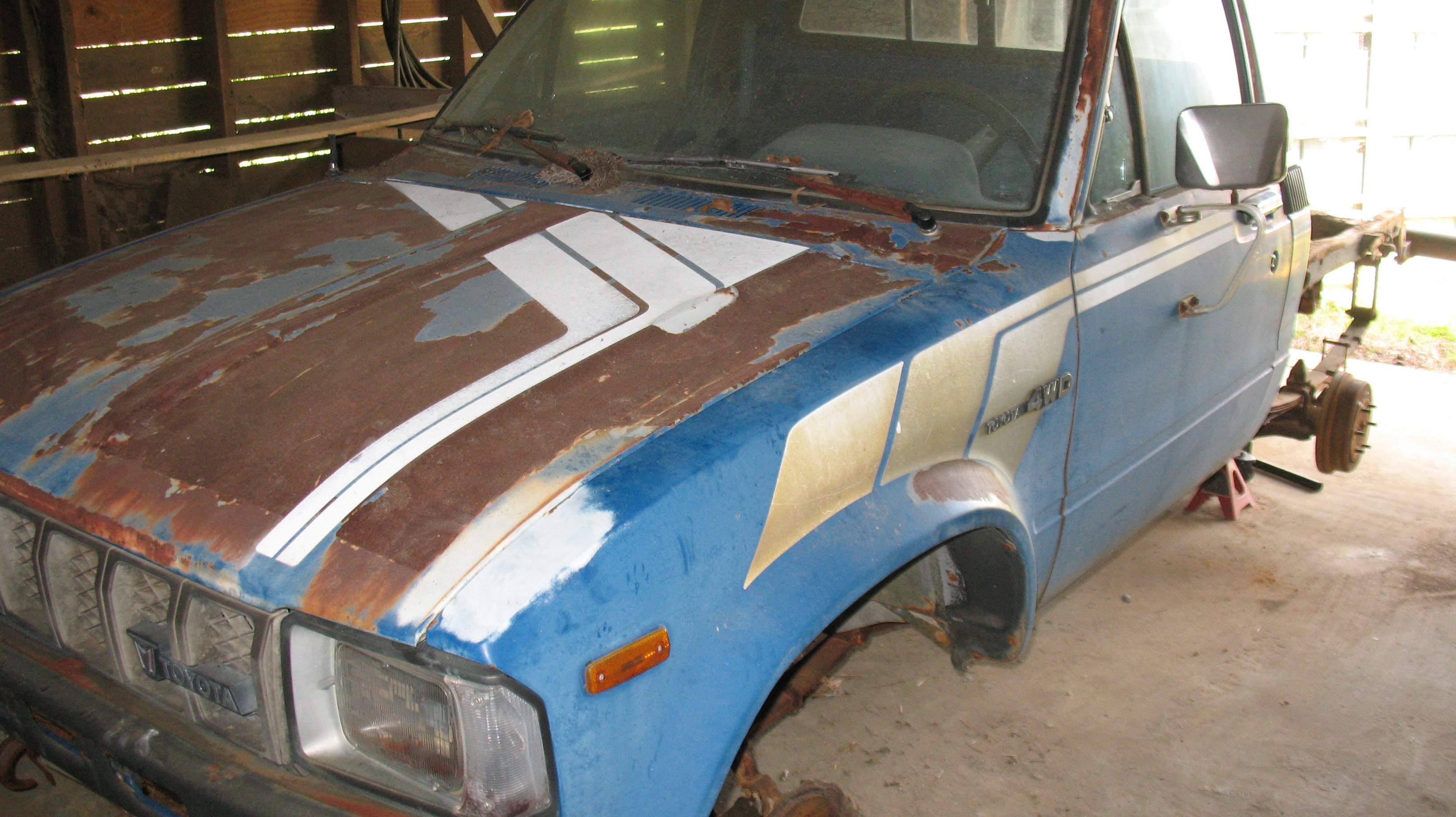

one more
