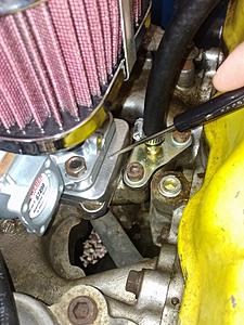

This is where I saw the fuel, it may have come from the other side but not sure.
Is the fuel dripping down to there (where the carb base attaches to what looks like an adapter plate) or is that where it is coming from?

It is from what I know its a stock mechanical fuel pump. I just went and adjusted the fuel pressure, when I first started the truck the pressure gauge jumped to 5.5 psi (that was at high idle), I am pretty sure I set it 3 psi but I dropped it to 2.5 at high idle and let it run until it got warm. Shut it off and no gas leak, the next time I drive it I will be sure to locate where the fuel is actually coming from. Maybe the fuel pressure was to high and causing it to flood after it is turned off, I will start the truck again before dark and check the fuel pressure once more.

You still have work to do. The place where the fuel is actually coming out of the carb needs to be sealed. So the question is . . . Was the fuel dripping down to where the carb base attaches to what looks like an adapter plate, or is that where it is coming from? It could be that a screw is loose, but a gasket could have been penetrated.

Is that a two piece LCengineering adapter? I would check those bolts if so. Fuel pressure regulator is a must also, people say otherwise, but it operates at that pressure for a specific reason. I had issues with my weber leaking, had to go and tighten stuff down every few months for a while too. I've also heard of people using lithium grease sticks on the gaskets to get a good seal, but I've never done it myself on fuel gaskets, just air.
Most, if not all, adapters are a casting, not a machined part. When I raced with a 32/36 I would test it with sandpaper on a very flat surface to find the imperfections.
