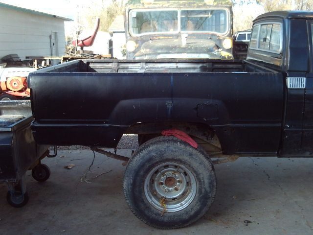

Oh, the truck behind the '86 is a '79. When I got my '80, my neighbor came over & offered his '79 to me. Cheap. So, of course I bought it. Then sold it to my friend who is slowly getting it roadworthy. The carcass beside it is an '82 camper that donated the 22R & front clip to the "79.

Speaking of beds...the '79 is now sporting the '86's bed & bumper. Body lines are off, but my buddy thinks it's a lot better than the hacked original.
