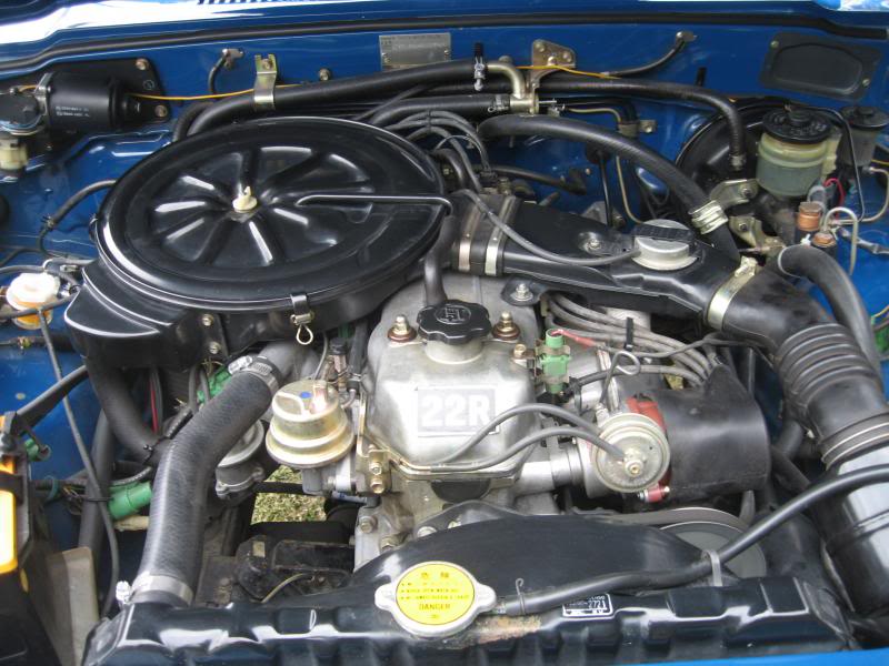

Heres a stock 22r setup in my 81 for comparison....Name:  81Toyo010_zpsb84ffbe9.jpg

But it's so... clean. How is this possible?

And that gold thing in front of the air filter, and just to the passenger side of the 22R, with the little blue dot in the middle of the top, is the fuel pump. Three bolts, three fuel lines and it's off. Very easy job. But my limited experience with mechanical fuel pumps is that they either work or they don't.
They're a very simple design. If it works, it works. But they don't work sometimes and not others. Think mechanical, not electric or vacuum. Mechanical stuff is either working or broken, for the most part.
Fuel filter is super easy. It'll either be along the frame, just forward of the gas tank (passenger side just behind the front door on the outside of the frame, I'm pretty sure), or it will be in your engine compartment near the carb. Two fuel lines and it's off.
The original owner had obsessive compulsive disorder, he kept the truck immaculate inside and out and it shows, plus the fact it was always garaged in So.Cal and only has 60k original miles.....
