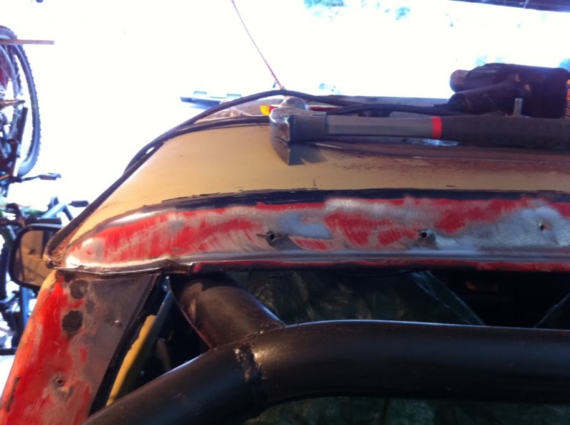

if you are thinking of doing a similar conversion and make a walk through cab with a metal bed, you can do it by leaving 4-6" of metal from either the rear of the cab or the bed and bending it over between the two to cover the gap between the cab/bed.

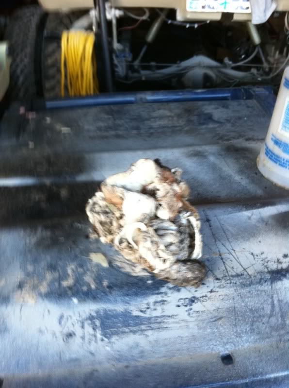

the butyl tape they used is crazy sticky and a major PITA to remove
i ended up with several baseball sized wads of it:
you could use a standard canopy seal, it is what I used when I made my top removeable.
for the gap between the bed and cab like I mentioned before, using the existing sheetmetal between the two will span the cab. just cut it and bend it over and screw it down. 4 Wheeler magazine did a nice write up on it in the mid 80's..hard to find the write up now though...
