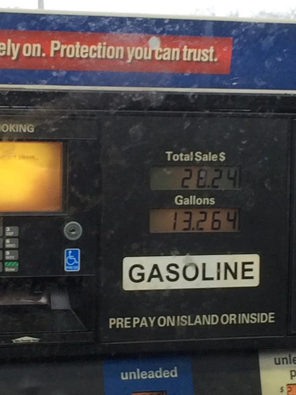

Anyways, i swapped the weber and filled it up about a week or so ago. Since then i was able to get 211 miles out of the tank. I did not let it go bone dry because i don't have a spare fuel tank anymore, but i figured it HAD to be close. So i filled it up with Plus (since fuel is currently cheap) According to the pump I got 13.264 gallons in the tank. As far as i have heard the stock tank on a 1982 toyota pickup is not even 13 gallons. Was i literally running on fumes or fuel deposits?
I figured that i would be getting slightly less fuel economy, but i don't know how empty it really is, so i can't properly calculate the my new MPGS.

Arco has been known to do that i guess. Mine is a long bed. Do the longbeds have larger tanks? I have never gotten more than 12.5 i think MAX, and that was when i did run all the way out.
Huh. I thought long beds came with a larger tank. But your experience means more than what I "think", so if you know you run out of gas before 13 gallons, I can't argue.
I don't know what's up with that.

Yo are saying that i actually have a 16 gallon tank in my long bed? I have never heard of that. Could there really be 3 gallons of crap in the bottom of the tank ?
If there was that much crap in the tank you would be changing fuel filter every week! I have run out of gas in my truck (short bed, small tank) where the truck just wouldn't start and there was less than a gallon left in it. Maybe your pickup tube isn't all the way at the bottom of the tank (I bent mine a little and sqeezed the tip to make sure it picked up from as low as possible) and there might still be a couple of gallons left in the tank when you run out because of the lack of baffles, the fuel sloshes around more in a large tank, it's just a guess.
