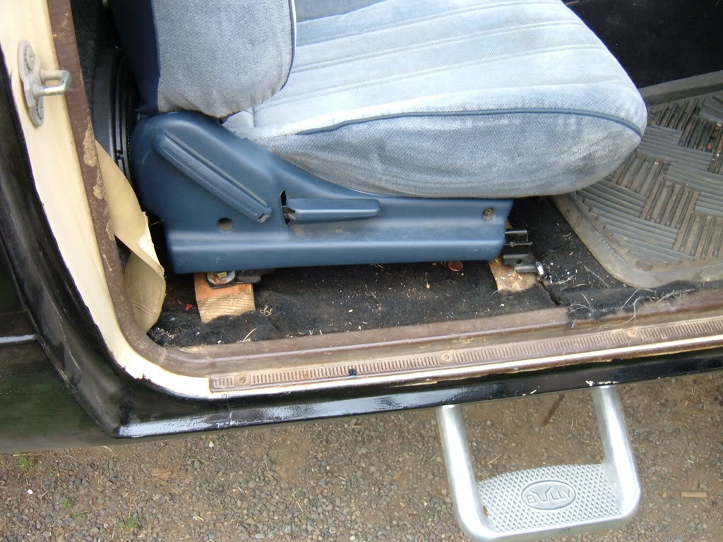

I have a question I went to the junk yard and got some civic seats didnt know there any other kind anyway small town not alot of options so they really dont bolt up execpt for maybe one think its worth makeing them fit ? cause they have no rips or nothing and look like new 91 civic seats there like an inch off the hole .

sorry lol I use worse grammer than a 5 yearold some days. I got one bolted in got to make the bracket above, And I used a piece of Pressure treated 2 by 2 to use as a spacer to keep the seat level instead of a bunch of washers...

2x2 PT: Sounds like the Civic seats are a little different that the acura seats. I only needed to come about 7/8" of an inch on the inside rear brackets.
post some pictures of the finished product. If they are like mine, it feels a lot better driving the truck

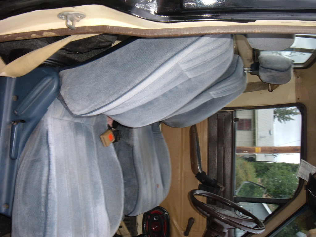

k heres mine. I had to redneck it a bit, Considering I dont have much laying around so I used some pressure treated 2/4 for spacers .they are alot better than the bench just need some goretex seat covers lol laters.
