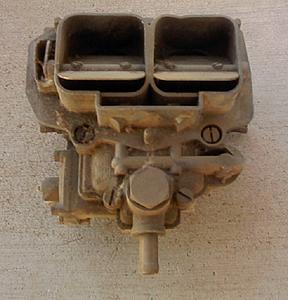

Hello Everyone,
I am in possession of that I think is a fake weber carb... The casting says "Weber", "Bologna" and "Italy". Any ideas on what the heck this thing is?

What makes you think it's fake? It looks like a real Weber to me. Typically the ones that are cast with the name and made in Italy are real. The Chinese ones just have a "W" sticker on the top and a "Weber" sticker on the side and the castings have no markings.
That one does look old and being made in Italy would add to that idea. The newer Webers are all made in Spain now. Maybe it's a 32/36. You'll have to pop the air filter off and look down the barrels to see if they're different sizes or the same size.
Another way to tell which isn't as fail-safe, is the choke on the knockoffs are usually black while the original Webers have white covers on the choke. Doesn't really apply for you though since you have a water controlled choke.

I guess I might have a diamond in the rough? LOL. I will take off the filter today to take a look down the barrel and let you know. The thing that got me really thinking was the front part of the carb where the fuel line enters. It doesn't look like the new webers. I'm in the process of sourcing some components to de-smog the little beast. I wanted to make sure I could follow something step by step, but the carb looked different and I held off. Are there any concerns I should have before I begin?

No problem! The top of the float bowl does look different from a 32/36 or a 38/38 where the fuel is entering but it's probably just an older design or a different model.

Good eye, it looks from the top one like of the other (usually smaller) Weber progressives. Since it is a 20R that might not be a bad thing.

For giggles I checked my Weber crates and found a couple similar looking carbs.
The first is a 40 DFAV - synchronized (vs progressive) - similar to the 38/38 DGAS. Looks pretty close to the OPs carb - and A LOT of carb for a 20R
36 DCD - synchronized also
Attached Thumbnails Says Weber...-40-dfav-sync-28s.jpg   Says Weber...-36-dcd-sync.jpg

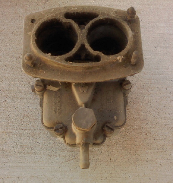

Okay, so I finally found the time to open everything up. Take a look:
Any ideas? I measured them and to me it looks like a 32/36.

It kinda looks like your picture vanished.

To keep this going, regardless of your lost image, if the barrels are different sizes then the carburetor would also be progressive rather than synchronous. So if you open the throttle by hand while looking down the top of the barrels, the smaller throttle plate will open before the larger throttle plate opens.
If both plates open as soon as you open the throttle then the carburetor is synchronized and the barrels are almost certainly the same size.
Does it run?
