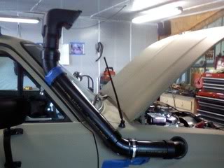

Can't buy one, build one.
x2! ABS pipe works great

That snorkel looks great! I'd love to see some more pics and I write-up on that one. Also I found an Airflow snorkel made for a Hilux that I think I can make work. What do y'all think?

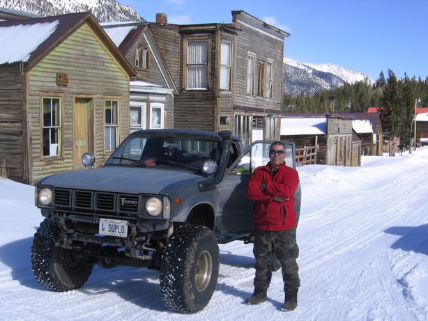

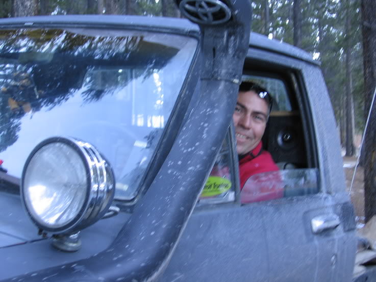

actually you're incorrect. The factory 1st gen intake is on the driver's side of the truck
the one posted by Gmack is routed to the passenger side:
old member Dirtoyboy's buddy had one correctly mounted on his 1st Gen:

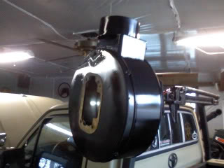

I built a air box (cookie tin) and connected it to the snorkel with tubing from a RV septic tube... I have about $80.00 in it. I have to replace the cookie tin, son broke it. I bought a water tight electrical box from Lowes... still have less than $100.00 in it. I am running a Weber, the box is bolted between the carb and the filter.
I found the head for the snorkel on Ebay.. and the pipe and rubber adapter came from Lowes.. hope this helps...
