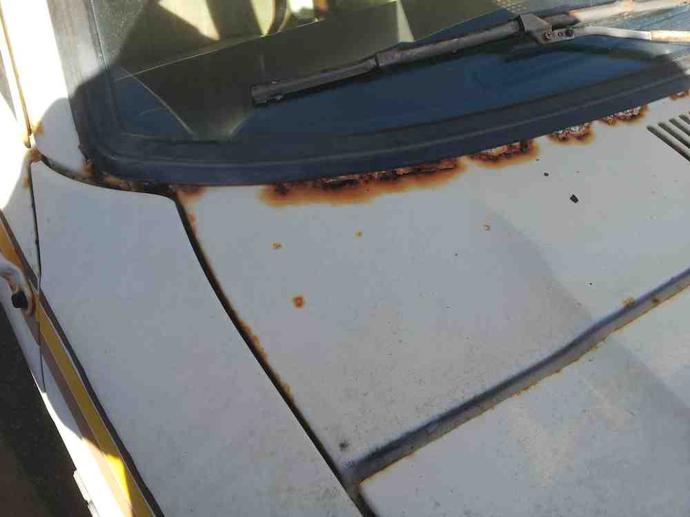

I need to remove the windshield from my 82 Toyota to deal with some rust (see photo) before I re-paint and then re-install the same windshield. I saw a few Youtube videos showing people removing and replacing windshields but they didn't go into as much detail as I'd like.

looking at the rust surrounding your windshield I am afraid you are going to be running into some severe rust hidden under the windshield seal. Pretty common problem on these trucks.
If you have been having a leak on your passenger side, it is a good indication of a lot of metal being gone,...

Yes thank you, and that rust is exactly why I need to remove the windshield.

If you're asking me... I pulled the window out and ground out the rust and used rust mort but its been sitting there with a tarp over the hood area to protect it from rain while I rebuild the interior (its a Toyota motorhome). I decided to do the painting when I'm done with everything else. I hope to be done in another three months.
