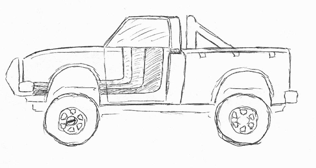

When I was a kid (1982) my neighbor had a 1979 Toyota 4x4 pickup. It had a black roll bar (a real fully-welded, heavy gauge steel roll bar; not a decorative "light bar") and a black "push bumper" (that's what he called it; not sure if that's what it's really called).
The wheels were steel with triangular cutouts which formed "spokes", like these, except they were flat black. The interesting thing about them was that they had very unusual wheel covers which I've never seen anywhere else, before or since. They were made of some sort of composite material, about 1/16" thick, and they fit like a skin on top of the steel wheels; having the same triangular cutouts. They had a woodgrain (!) pattern printed on them.
The truck was black and had three "hockey stick" shaped stripes on each side, which started on the doors and then went to the front of the truck, sort of like this:
Each stripe was a different shade of gray.
The truck also had a sunroof and a sliding rear window.
My neighbor claimed that the truck came from the factory exactly like that.
Question 1: In 1979, did Toyota offer a roll bar and "push bumper" as a factory option? What about those weird woodgrained wheel covers?
Question 2: If the truck was indeed a factory option package, does anyone know the name of the package?
Question 3: Does anyone have any pictures of that style of stripes, or any of the other things I mentioned? Also, does anyone reproduce that style of stripes?
Code:
| | | | | | | | | | | \______________________ | | \________________________ | \_____________________________ \___________________________________
