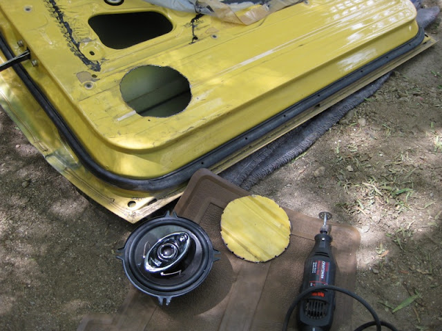

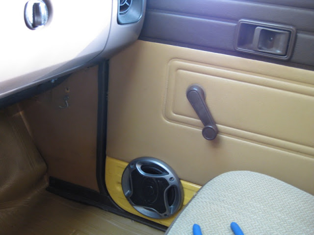

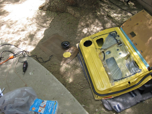

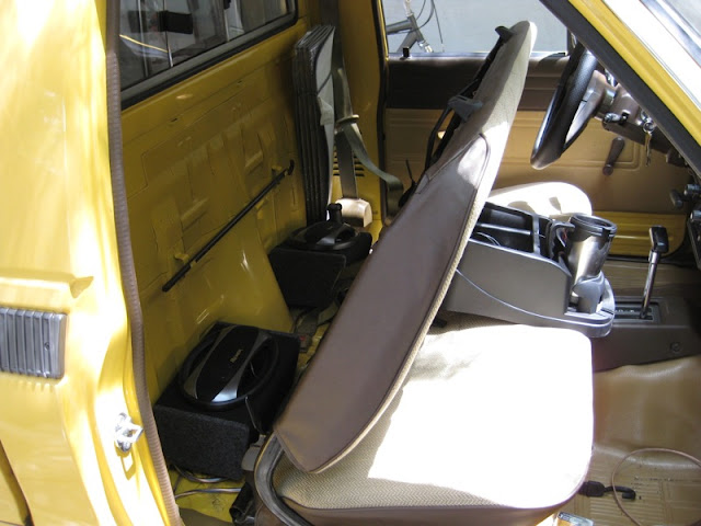

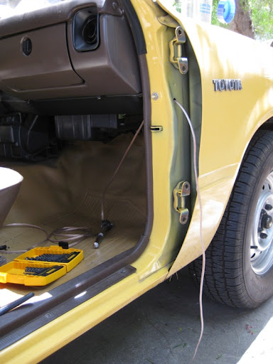

Well, I installed the head unit last weekend and finished up the speakers this weekend. I've got a broken arm right now which makes working behind the dash quite frustrating, but I managed and am very happy with how everything turned out.
I ended up cutting holes in the doors for 5 1/4" speakers, including a small amount from the wood door panels. This truck will be with me for the remainder of its life, and I figured if I did a good job I wouldn't regret cutting the panels. I took my time and it looks professional.
The sound is excellent for such a little cab. Two 6"x9" Pioneers in boxes behind the seat provide good power and bass, while 5.25" Pioneers in the doors even things out. The head unit is 22x4 watts RMS. I'm not using an amp or anything fancy, just quality speakers and a quality stereo. The Retrosound is a great option for those that still have the original dash trim. I used the black universal knob kit without any front panel. Seems to have all the modern features, a nice intuitive interface, nice clear sound, all packaged in the old 2-shaft style.

6"x9" boxes behind the seats, also a nice fit:
Drilling holes for the speaker wire, there were none:
Cutting front speaker holes:
Front speakers installed:
