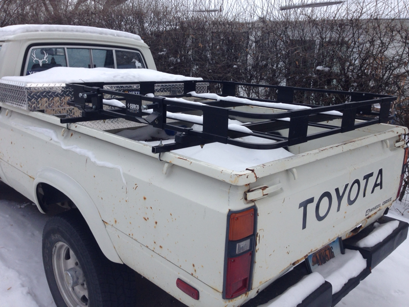

I wanted to do the same thing had a rack welded and all but just couldn't get myself to drill the roof so mounted mine on the bed rails. Nice if I need to use the bed I can unbolt it in about a minute.

If you didn't mind having a headache rack that might be an option. Might have to drill into the bed though

Highonpottery hit it, I used to work at a bike shop back in the 90's and we sold Thule products. They made a gutter fit kit that clamps to your factory drip rail. I wouldn't go putting a bunch of weight on it, but I imagine that it could probably hold 200 lbs without a problem. I also saw on here earlier where somebody was selling a Kargo bed/rook rack for $400 out of Virginia. I know it wasn't for first gen pickups, but there is a chance that it could be modded to fit.
I also did something similar to what 406dru posted on my 92 Ranger when I was 16. I had a tonneau cover that I had a Thule rack clamped to the outside of. Worked out really well, looked clean and removed easily.
